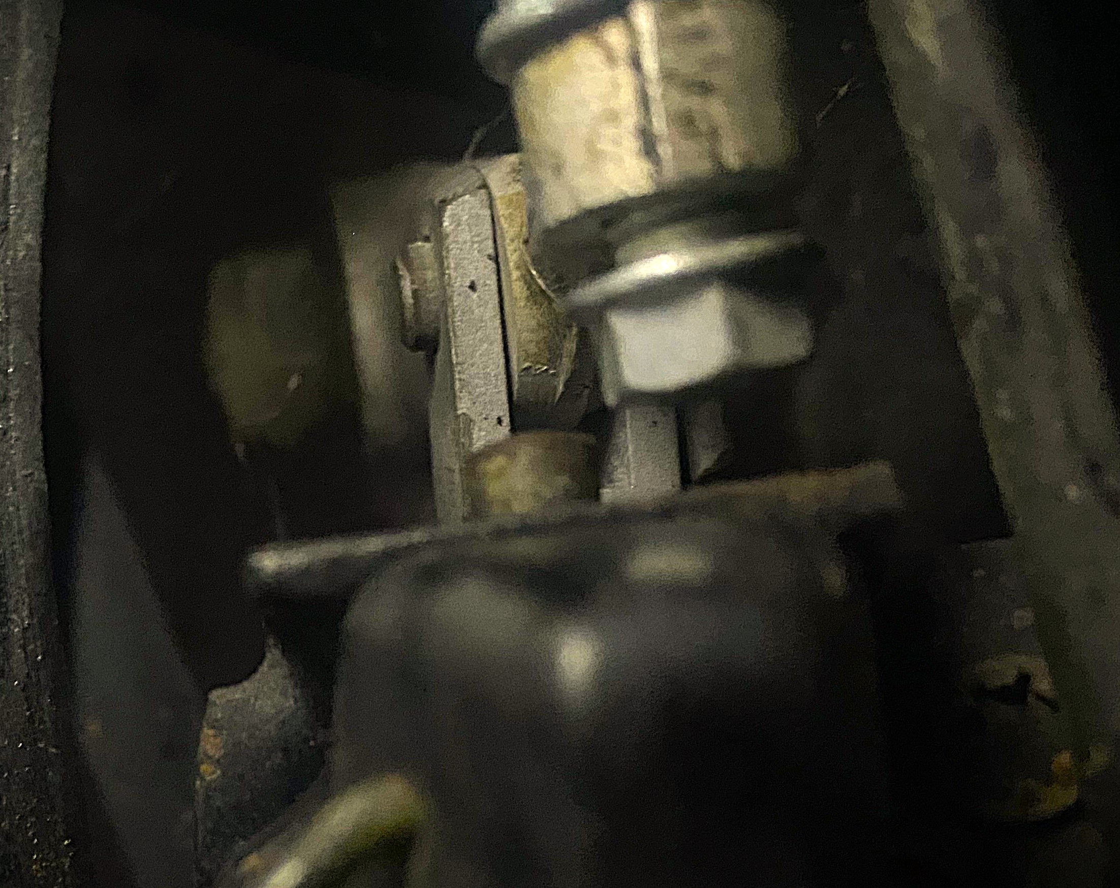

Anyone have a photo of your rear brake switch setup?
Re: rear brake- light not activating
You're right it is busy down there but I think I can see a problem with what you have....
What I think I'm seeing is the top of the brake lever casting towards the top of the page with the switch lower down. The bolt at the top is threaded into the top of the lever and, when the brake is off, comes into contact with the metal bracket attached to the frame. The actuating plunger for the brake light switch protrudes through a hole in the bracket.
If my view is correct than there is an obvious problem (or indeed a couple).
1) The aforementioned bolt isn't the right one. The correct bolt has a slightly domed head. This may or may not have a bearing on your problem.
2) The bolt doubles as the height adjusting stop for the brake pedal in the off position and as the actuator for the brake switch. It should align with the switch plunger and, as the lever returns to the off position, it should press the plunger turning the light off.
In case you haven't worked it out... the switch is a 'Normally on' switch which is on when the plunger is extended and off when it is pressed in.
In the your picture the bolt is not aligned with the switch plunger and will never press it in...
Which brings us to...
3) If the plunger is never being press by the lever, then in principal, the brake lamp should be constantly on... which, if my understanding is right, it isn't... so that implies that there is something else wrong with the circuit, possibly a faulty switch or wiring but also possibly something done by a previous owner to prevent the brake light being permanently activated.
eriojas wrote: Fri Apr 04, 2025 9:56 pm My 1979 R100Rs, cant align rear brake pedal with the switch activator, so brake light stays on always, is there any way to adjust the brake pedal mechanism ? The switch has a fixed bracket , no adjustment
I would 'adjust' it with a strategically placed hammer blow.

Thks Rob, its exactly as you described, the brake light is always on, if I depress the plunger it goes off, so the switch it works perfectly, the brake lever bolt is misaligned, the bolt you mention is the right one has a thicker head, as you also say, if the brake lever is bent, trying to bend it may break it, maybe a big washer that pushes the plunger may work, will try to find the right bolt

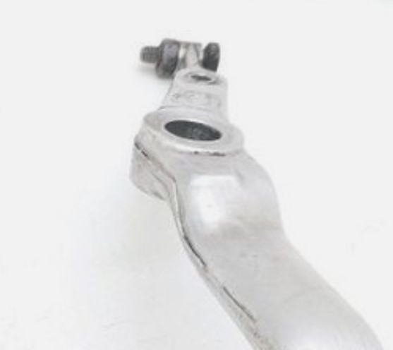

The brake lever is cast so is in danger of snapping. Removing the lever is easy enough. Can you do that to inspect and maybe post a picture? If you use some strategic brutane with a solid tool, it'll be safer and easier off the bike.
If all else is good then a McGuyver fix might be to change that bolt head so it's wider and presses the switch plunger. A spot weld to the top of the nut or a nut with a wider head?
Hopefully you can get away with it without breaking and replacing it. It won't need to move far though if you whack it. Fingers crossed.
foot brake lever.jpg (15.68 KiB) Viewed 10828 times

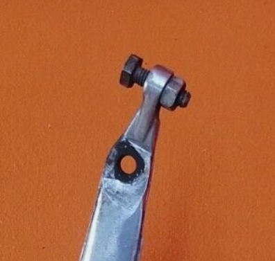

Maybe the correct bolt will do the job.
The one in this picture is different to the one in yours.
pn 35 21 1 231 067 HEX BOLT - M6X20-8.8ZNS3
Shouldn't be hard to source locally.
lever nut bolt.jpg (27.32 KiB) Viewed 10823 times
