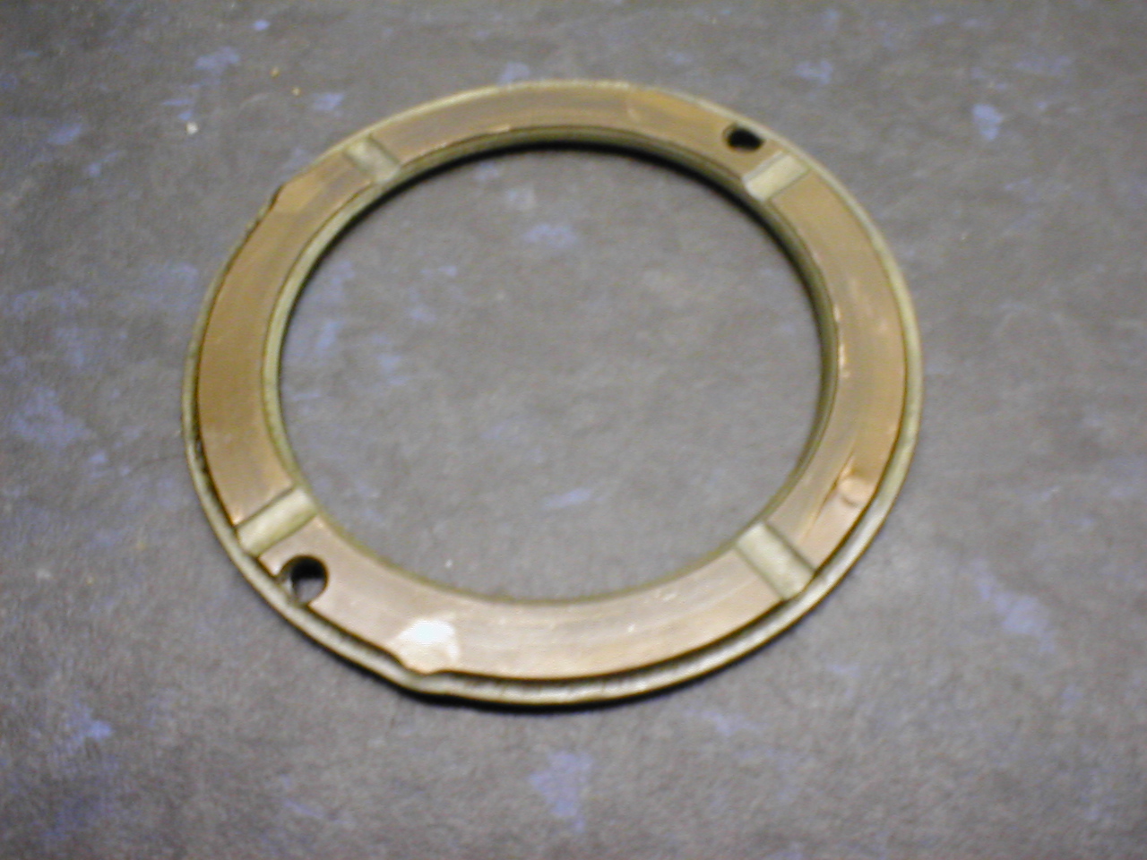

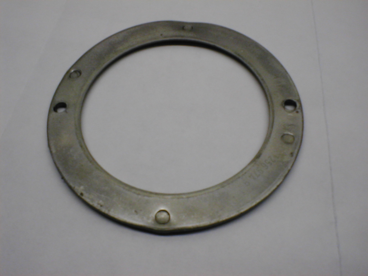

The obvious thought is that the inner thrust bearing has slipped off the two locating pins so you're actually locking your new bearings against the ends of the pins. This isn't a good thought! Assuming the cylinders are still off the engine, you should be able to see if the inner thrust bearing is standing proud.
If the bearing isn't seated, then you need take it out again and examine the bearing itself. Typically nipping up the flywheel bolts will damage the bearing face and there's nothing for it but another new thrust bearing. I you're VERY lucky and the bearing isn't damaged, it's simply a matter of putting it all back together making sure that the bearing stays on it's locating pins, then putting the flywheel on.
Slightly off topic but not unconnected... whenever you remove the flywheel (or even loosen the bolts), it is a very good idea to block the crank rearwards so that it cannot move It only needs to move a few mm to allow the thrust bearing to come off the pins. To emphasis the point, below are a couple of pics showing a thrust bearing from an engine where the flywheel has been tightened with the bearing off the pins (twice by the look of it). As you can see, it is completely useless.
Back
And Front
