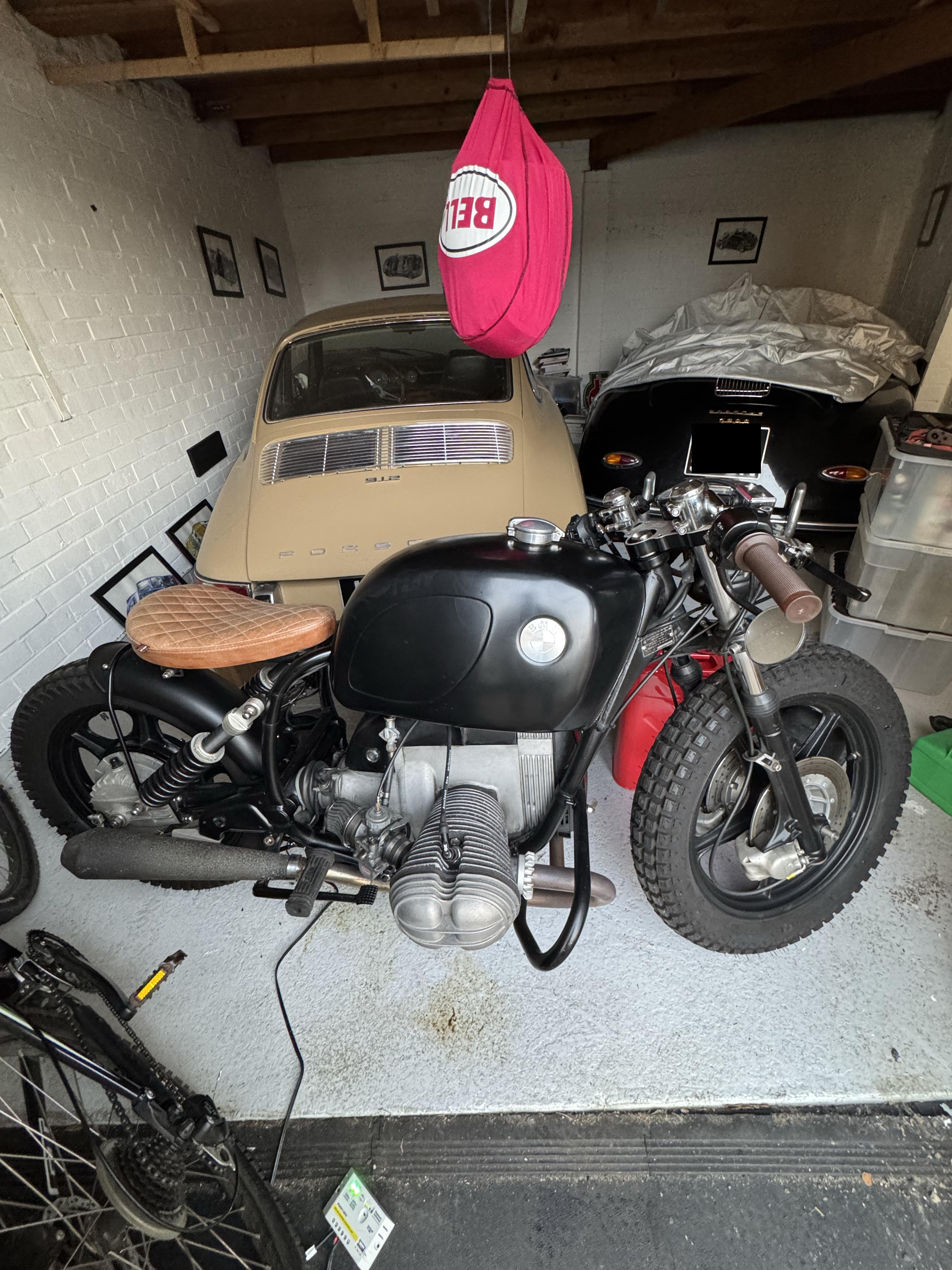

The bike is a custom build and has been made into a bobber, so it has a somewhat unusual layout. For example, to change the battery I have to take one of the exhausts off as it sits in a space inbetween both exhausts. Its unusual, but not an issue as long as the battery doesn't need changing.
Because it has sat for a while (House renovations got in the way of ridining for a while) I needed to change the battery and therefore remove the left exhaust. Once the battery was changed and the exhaust all fitted back together the bike had power, everything lit up. All lights and horn worked, but the bike wouldn't start.

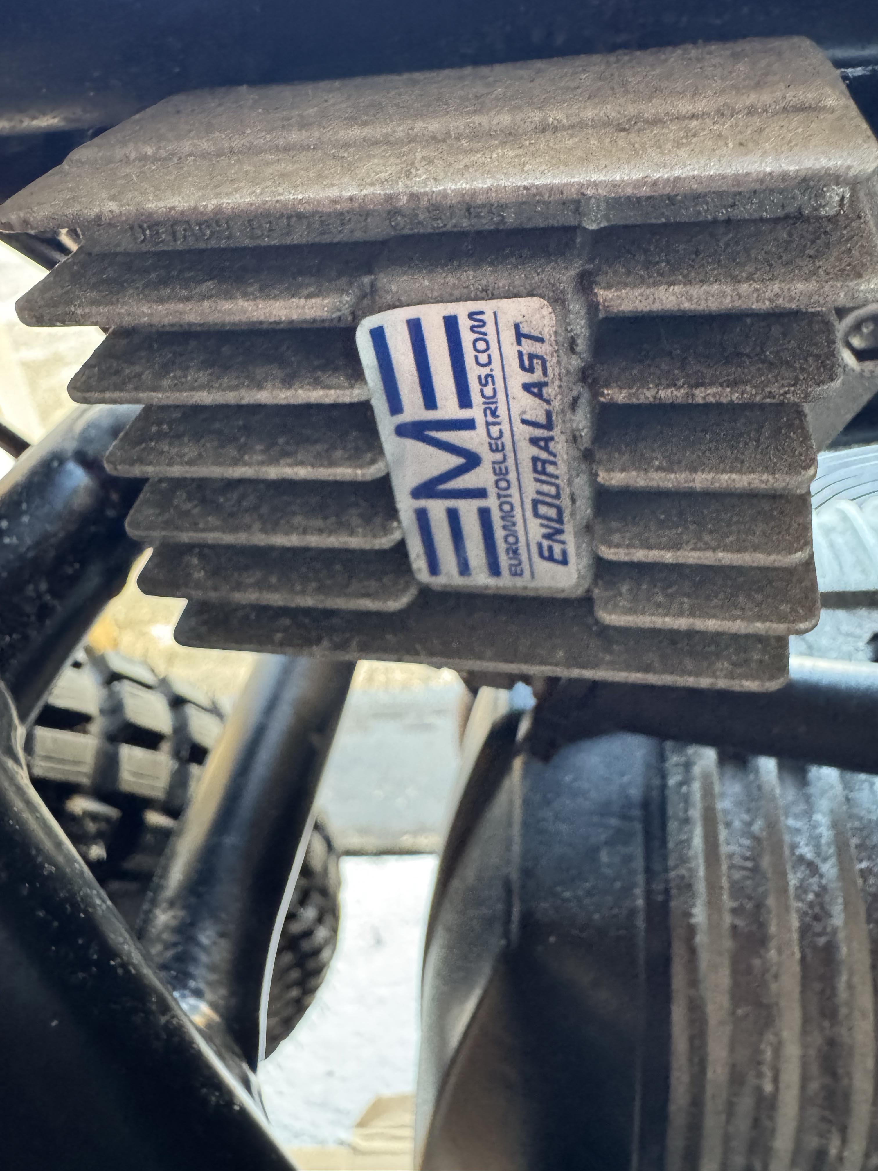

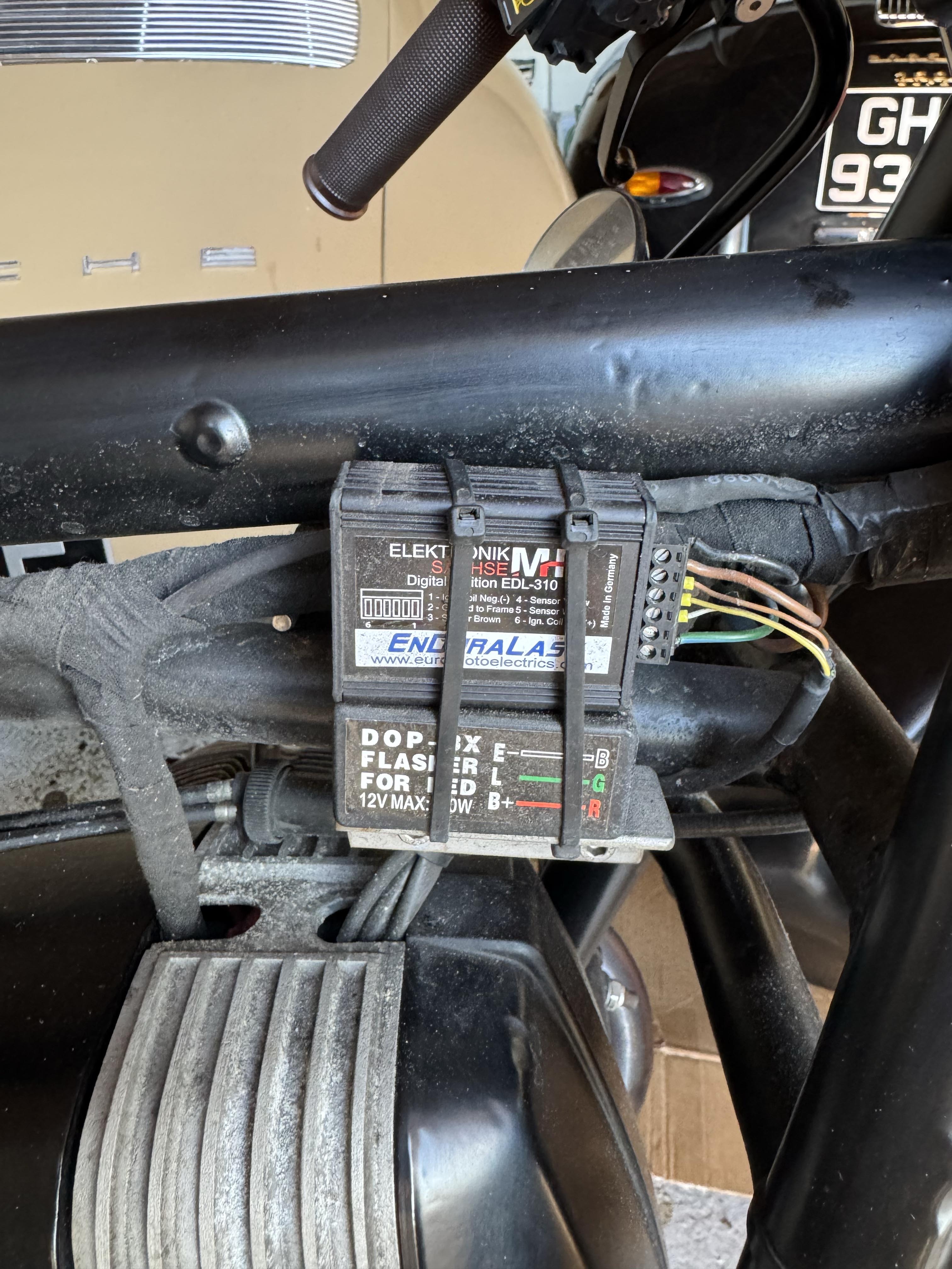

The bike has an electronic starting kit by Enduralast and that's the last thing on my list to replace (and probably the most expensive) however, I know very little about mechanics and electronics so I'm just muddling through and quite enjoying it apart from the frustrations of failure! The engine is spinning on start but not sparking, does this mean that with what has been replaced, that the electronic ignition is working? (I'm not sure if the initial spin is from the ignition system or not, please forgive my ignorance) or is it probably fried and I need to replace parts of it or is there anything else I should be looking for? As I say the bike was faultless before taking the exhaust off and I've checked all grounding and loose wires etc.

The Enduralast installation instructions confirm that the unit must be used with a coil (or coil combination) having a (combined) primary resistance of between 2 and 4 Ohms. They specifically state that the dual coil found on later airheads, with a primary resistance of 0.7 Ohms) is NOT compatible.
