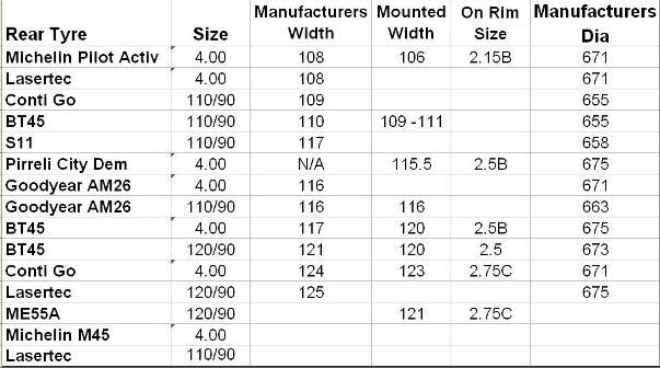

If you mean 110mm is the mounted width it should come out easily enough as that is towards the narrow end of mounted tyre widths. Deflated it should come out no problem with the right preparations. For me that means removing rear mudguard so it will pull out straight.
This is many years out of date but it gives you an idea of mounted tyre widths
Tire Sizes.JPG (45.09 KiB) Viewed 4538 times

It would be worth checking the various tyre manufacturers websites to see if they have dimensional data for your list of tyres although my data was gathered a long time ago and not all manufacturers provided data even then. Some of the mounted widths came from members measuring the their own mounted tires.
