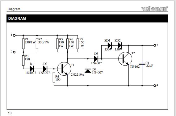

I would certainly not short the plug leads on electronic ignition although I've done it on points ignition including with my kit built ignition amplifier in place after noting that there are several blocking diodes in the electronic circuit to protect against a back emf and there is a condenser to absorb the back emf as well.
It's worth explaining why I judged that to be safe.
The coil will have a fixed amount of energy in Joules that get dissipated regardless of whether there is a spark gap or a dead short. The HT current that creates will depend on the HT voltage which will rise until it creates a spark across the plug gap. If it's a dead short instead of a gap then voltage doesn't get to rise as much and so the HT current will be many times greater than normal. Simple ohms law.
On proper electronic ignition with coils of low primary resistance the joules stored in the coil will be at least 4 times greater than for points coils making the HT current at least 4 times higher on a dead short so there is much more potential to do damage.

Good point, a dead short is not worse than a fouled plug as an open circuit will cause the coil to generate it's highest possible HT voltage which stresses the coil insulation and may lead to damage on electronic ignitions. There does seem to be a consensus on not pulling a HT lead off to disable one cylinder when electronic ignition is fitted. The shorting method has to safer than that.
There's no getting away from the fact that shorting will increase the HT current many times and while I've used the shorting method on my points booster electronic ignition without any adverse effects it does retain the original points coils which limits the energy being dissipated.
I suppose there is a difference between risking my own kit built points booster which cost all of £10 and advising someone else to risk their fancy aftermarket electronic ignition which may have cost $$$.
Not knowing the details of your points booster, I can't really comment but, if it's essentially substituting a semiconductor switch for the points (no matter how triggered)... as you say, the energy dissipated in the igniton system is dependant on the coils rather than the switching method so your system using the original coils probably doesn't greatly increase the energy being produced.
A little less energy because unlike the points contacts there is always going to be a fractional voltage drop across the collector-emitter on the TIP162 power transistor. It was measurable too as I checked average primary current before and after installation and it was fractionally lower.
In general, a transistorised system like this will switch more quickly and cleanly than points so, if you are losing energy due to the forward bias of the transistor, you are probably making up for it.
