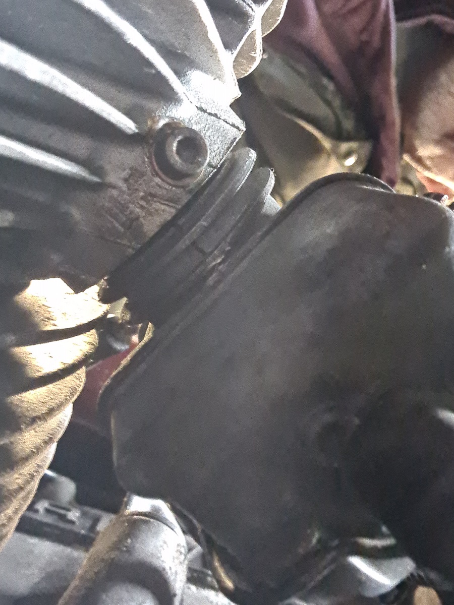

2) My R60/6 (original carbs) has the head side flangs of both drilled for a take off. This allows a normal pair of manometers or gauges to be used. The benefit of doing both carbs at the same time is that, then, you can be sure that the same variables apply to both.

Re: Balancing slide carburettors
Apologies, my post was misleading. It's the heads that have been drilled and threaded (not by me but by a PO) Normally the resultant holes are blocked with a screw. I've had to make a pair of adaptors to connect vacuum gauges. Will try to get a photo later.
Image of the balance ports drilled in the underside of the ports on the head... 6mm tapped hole, the outside of the hole is face flat and the 6mm allen screw has a copper washer.Probablw wouldn't have done it myself but it works fine...
Thanks Rob and a nice unobtrusive mod.
