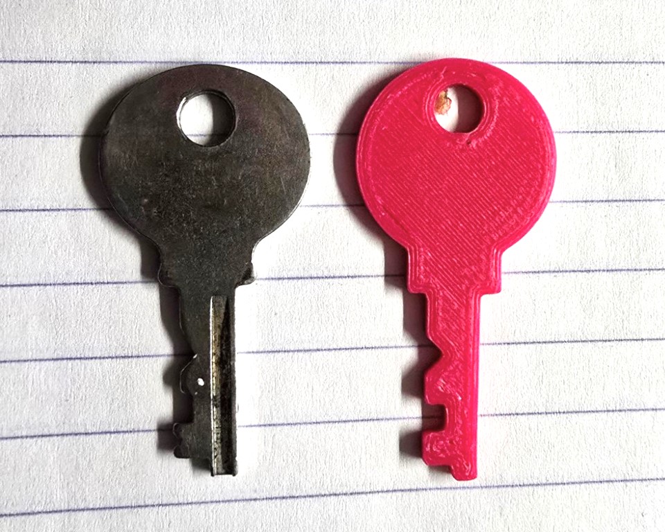

BMW touring panniers 3d key printing.
I know nothing about 3D printing, nor do I have a 3D printer.
However, I have a mate that does and he's having a crack at making some blanks.
These keys are not much more than suitcase keys and it's only the first 4-5mm of the key that enters the lock.
Each differently coded key has the same cut.
The point of difference to each code is the combination of the slotted keyways. Some are single sided slots, some double sided, some slots are square/rectangular and some are triangular shaped, central or edged.
Making the blank is likely the easy bit.
A work in progress. Hopefully there'll be a happy and functional ending :?:
EDIT: If anyone can be bothered, I'm after 3 pictures of each key, BY PM please (I've been lead to believe there are trust issues in the world and people might be roaming the streets looking to undo airhead pannier cases.)
If you do the pix, both sides and the view from the tip to see the keyway depth and shape. They're all cut the same so that's easy, the keyway profile provides the point of difference. I won't post them here.
Image Image
First copy..jpg (206.28 KiB) Viewed 2632 times

Yes, interesting. I have done similar by cutting a blank from steel stock. The shank 'section' is the tricky bit.
My reservation about 3D printing is the durability of the key in normal use, especialy as, on some sections, the material is very thin. Would make a good emergency spare though. I'm sure someone with a CNC machine could turn them out by the dozen... in alumium alloy if they can't handle steel.
Re: BMW classic panniers 3d key printing.
Rob Frankham wrote: Mon Dec 01, 2025 9:59 am Yes, interesting. I have done similar by cutting a blank from steel stock. The shank 'section' is the tricky bit.
The mate doing this also has a cnc machine. It's been mentioned :)
The durability has been the major point of discussion, but as the lock is a loose and easy suitcase style lock, it's worth a shot!

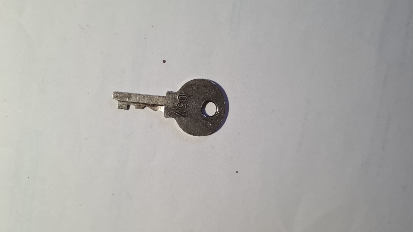

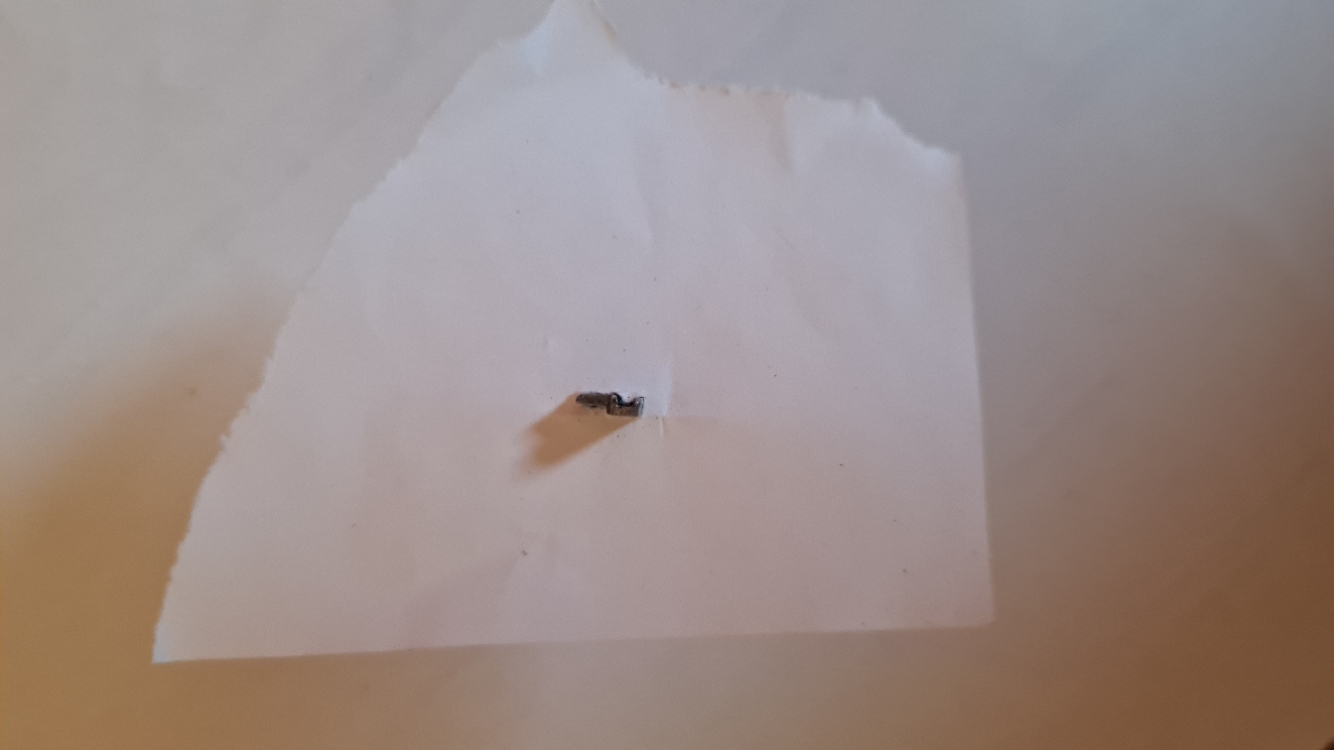

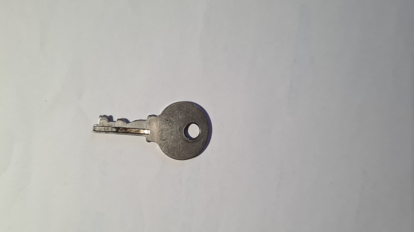

Herewith 4 photos of the 057 Key. Taking an image of the section was quite difficult so I've included a drawing of the end of the key with dimensions (Very much not to scale but the measurements are as good as a digital caliper can do (and a lot more accurate than necessary for the key to opperate)). Ok, I can only post 3 so the other one will be on an additional post...
Key 057 Top.jpg (201.47 KiB) Viewed 2054 times
Key 057 Profile (photo).jpg (187.64 KiB) Viewed 2054 times
Key 057 Bottom.jpg (161.04 KiB) Viewed 2054 times
One more image...
Key 057 Profile.jpg (246.81 KiB) Viewed 2054 times
