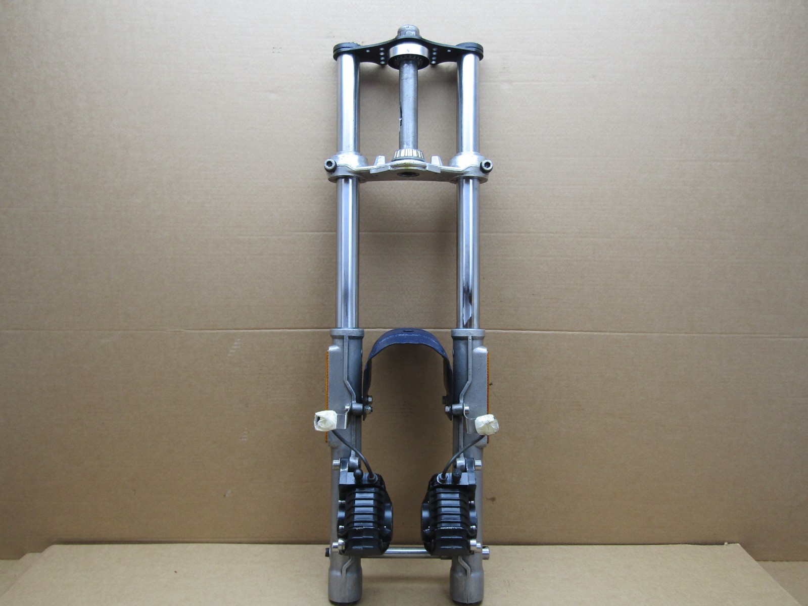

JohnT
Posts: 42
Joined: Mon Feb 10, 2025 9:50 am
Re: Fork/Brake Upgrade for Early '80 R80 TIC?
Post by JohnT »
This may help you search and identify suitable parts.
My old 1984 Ex Police R80 with twin Brembo brakes.
Todd
Posts: 10
Joined: Tue Dec 16, 2025 6:30 pm
Post by Todd »
JohnT wrote: Wed Dec 17, 2025 10:45 amMy old 1984 Ex Police R80 with twin Brembo brakes.
Thanks. Nice full front mudguard ... Yes, that's the set up basically. So far I've been told that they also did an R100TIC with spoked wheels for the Police too, although; a) they're rare ... if there's any original survivors left at all (9 licenced, 7 on SORN), and b) they shared a narrower hub than the ATE caliper version.
I'm wondering if going for a bigger rotor, better caliper, single sided brake might be the way forward, i.e. like an R80ST set up? Does fork twist perhaps become an issue ...
The R80ST uses the same fork sliders as the R65 and some R65s used to have double discs.
