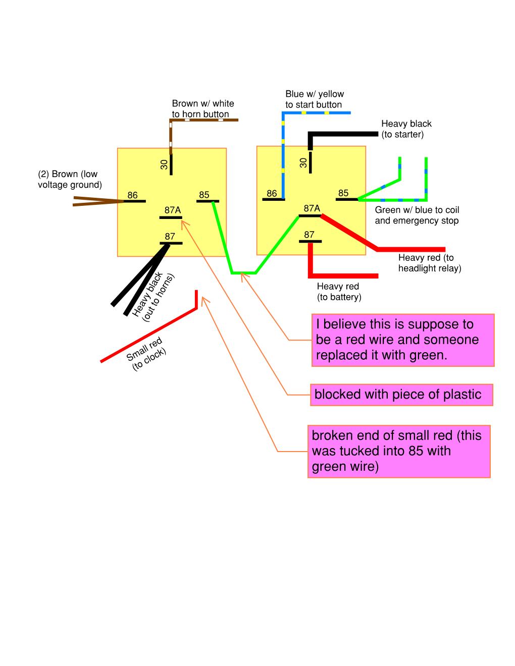

I got a new relay finally and now believe someone had it wired up incorrectly. I diagramed what I have so I could compare it to the wiring harness in the clymer manual. Everything on the starter relay makes sense and looks right (except the green wire which is supposed to be red), but I think someone replaced it with a green wire to tie to the horn relay and maybe mixed up the terminals when they did. I think I just have to figure out how to de-pin the brown and green wires and swap them so the green goes to 30 and the brown with white goes to 85 (though as the starter relay goes to ground through 30, maybe that is where the black wires to the horns should be and the green should go to 87...hmmm).
If anyone is familiar with these, can you confirm that:
A) The horn relay should be 4 pin (the socket for 87A on that terminal appears to be blocked with a solid piece of plastic)
B) the brown with white goes into 85
C) the red wire to the clock should connect to wherever I put green (though I may replace with a correct red).
Many thanks,
jason in Seattle
Many thanks,
jason in Seattle
