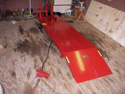

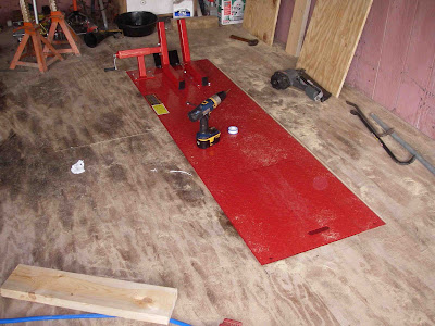

I bought the better of the Harbor Freight lifts by accident but I am very glad I did. I have nothing bad to say about the lift and one of my bikes is always parked on it using the front wheel clamp only. I only use straps when I am working on something.

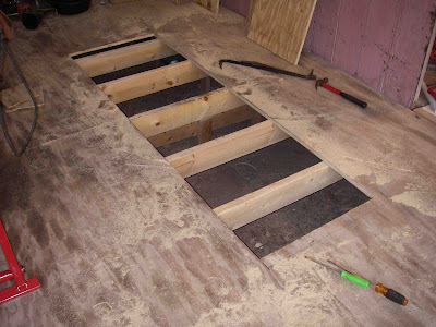

It took up too much room so I modified my floor a little and sawed eight inches off the legs of my stool.
Its air operated and I ran the foot control seen in the first picture under the deck to about where the hammer is sitting in the last picture.
