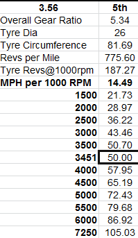

Nearest would be 32/9 or 3.56.
Taking account of the 1.5 reduction in the gearbox that makes an overall ratio of 5.34
Here the chart recalculated for a 3.56
- 3.56.png (6.72 KiB) Viewed 4605 times

Thanks Barry, that confirms my arithmetic .
