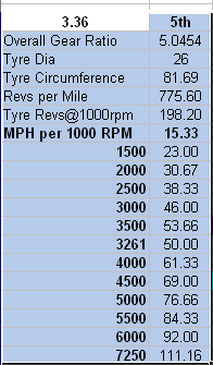

Tach should be normally be more accurate but I think not in your case at 7500 RPM. Assuming you have a 37/11 or 3.36 final drive and a stock 4.00x18 rear tire RPM vs MPH should look like this. If your final drive is different to stock post up what it is and I'll run the spreadsheet again.

Thanks for the offer Barry .... but I have no idea what my final drive ration is having never pulled it but it certainly seems low. The web tells me an ST should be good for 106 mph but that 7500 rpm came up pretty easily and quickly and I think she had a bit left .... so I certainly must be pulling a unusually low ratio.

37/11. = 3.36.
This sees to indicate my tacho is inaccurate because the 7500 rpm I saw would give 115mph and that seems pretty unrealistic .
