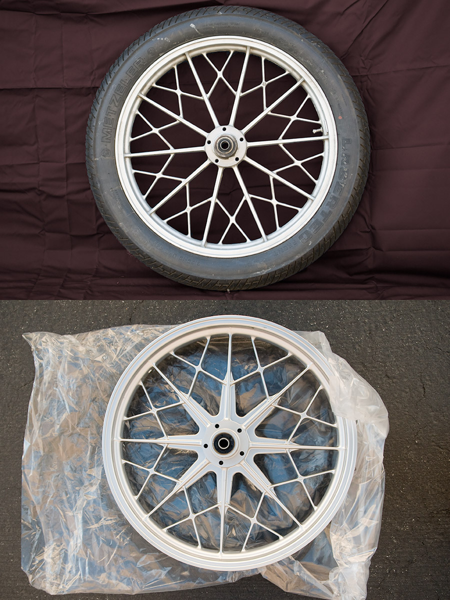

Hard to tell, but isn't that a recall front wheel?

What's a recall front wheel, and string line the frame?

Image Top wheel is recall wheel, bottom is braced replacement. I think BMW will still replace the recall wheel if it is original to the bike.
