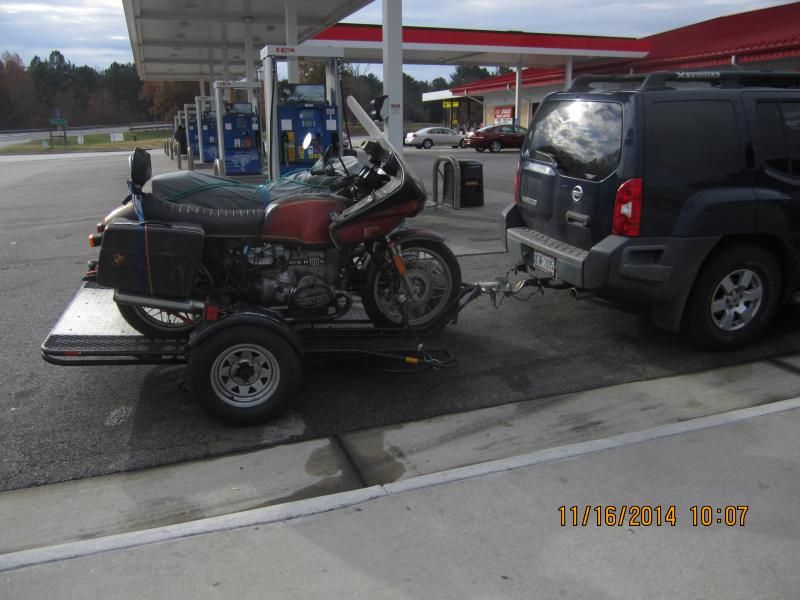

I've bought my first airhead that has 78k miles whose orig owner passed away over 20 years ago. The bike hasn't been touched since. After I get a home here in Ca I'm going to get it shipped from NC. looking for input on good steps to get her back on line

We'll look forward to seeing it. Any pictures for us? Wires or mags, colour, stock or modded etc?
At first guess...all fluids will need changing, new tyres and go over the electrical connections and clean them up.

This is Beatrice, the original back seater.
