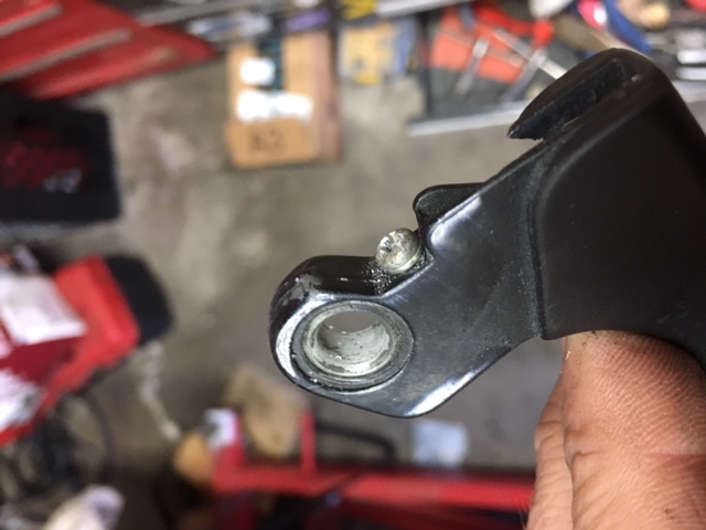

Here is an update -
The switch works in my perch but the handle has an indentation in it so there is not a tab that activates the switch. I went through all my spare handles and the left side does not have that indentation, the right side handles do. So... i Drilled a small hole in it, tapped it, put a screw in it and now it will activate the switch.

Re: Handlebar clutch switch as a brake switch?
Ah, that's right. On mine, I machined a little metal cap for the pin to lengthen it. Edited my post for clarity.
I got everything wired today and the clutch swap into brake switch works!
