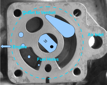

If you took the enrichment circuit apart, be aware that the disc needs to go in correctly for it to work.
And if memory serves, their orientation is mirrored each other on the two carbs?
I believe one of our contributors from England has a page with pictures. Rob Frankham? It looks like Rob's site is down.
Anyway, if you have not started already, take LOTS of pictures as you take things apart, so you have a reference putting them back.
edit:
From Largiader's website:
http://www.largiader.com/tech/carbs/The choke is very important. Disassemble the choke assembly so you have the aluminum disc by itself and you will see a series of four small holes in an arc, with decreasing diameters. On bikes with a two-position detent on the cold-start lever only two of the holes are drilled through, but on older bikes three are. Each of these holes must be clear; they give you the increasing fuel enrichment as the disc is turned. When reassembling, make sure the gasket is flat and that the metal surfaces are clean and dry. It is almost certain that you will have to replace these gaskets because the old ones have sucked inwards.*

It's very easy to be sure the enrichers are correctly assembled. Just make sure the pear shaped slot is at the top of the disc and the narrow end points towards the cylinder head. Visualise how the enrichers work with the pear shaped slot allowing no air in the off position and progressively more air into the outlet port to match the increasing size of the 4 fuel holes. Once you understand how they work you can't get it wrong.
- output_nZucqi.gif (235.68 KiB) Viewed 3826 times
