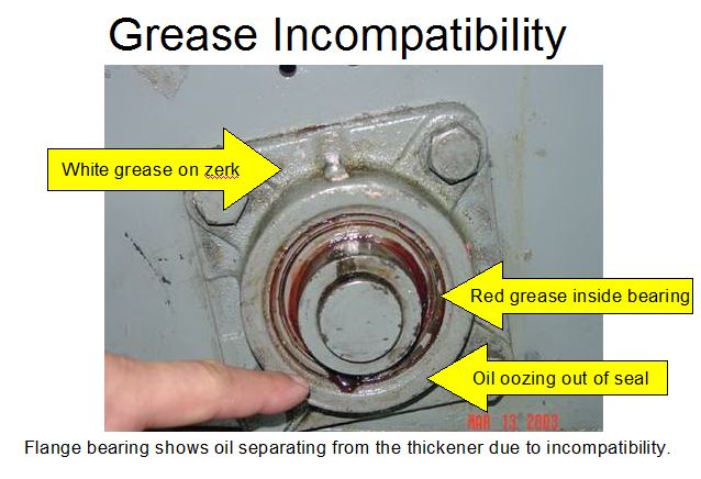

seal leaking, red grease is good in flange bearings, white grease wtf was he thinking

richard t wrote: Mon Apr 16, 2018 10:54 pm seal leaking, red grease is good in flange bearings, white grease wtf was he thinking
I'm guessing he was thinking grease is grease. Hit don't matter none.
