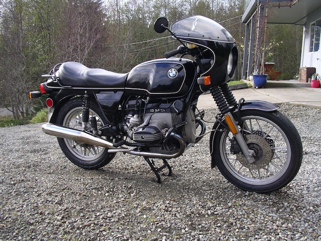

I put the hd BMW fork springs in a long time ago, they seem to be sitting up fine. Isn't the ride height the issue? I'm more worried about deteriorating bumpers and internal parts.

Re: Rebuild forks?
Zombie Master wrote: Tue Sep 11, 2018 1:25 am
No bumpers, and only about five bits in there. I haven't worn mine out yet.
Although I did put a 12mm spacer on top of the springs. Noticeable.
Re: Rebuild forks?
ME 109 wrote: Tue Sep 11, 2018 7:33 am
Thanx! I did replace fork seals at one point. :)
