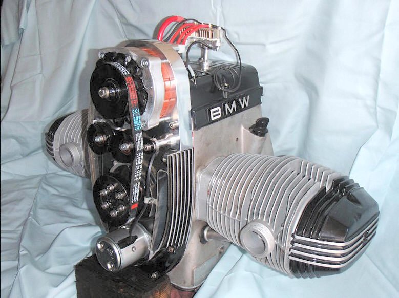

800WattAlternator copy.jpg (83.31 KiB) Viewed 2245 times
Maybe one of these:

Zombie Master wrote: Sun Sep 26, 2021 2:19 am 800WattAlternator copy.jpgMaybe one of these:
BMW figured it out on their other bikes by the time airhead production was on death row.
The pic you posted looks cool at first glance, somebody put a lot of thought and work into that.
But look closely; That top pulley is way too big, that thing will still spin at about crankshaft speed.
