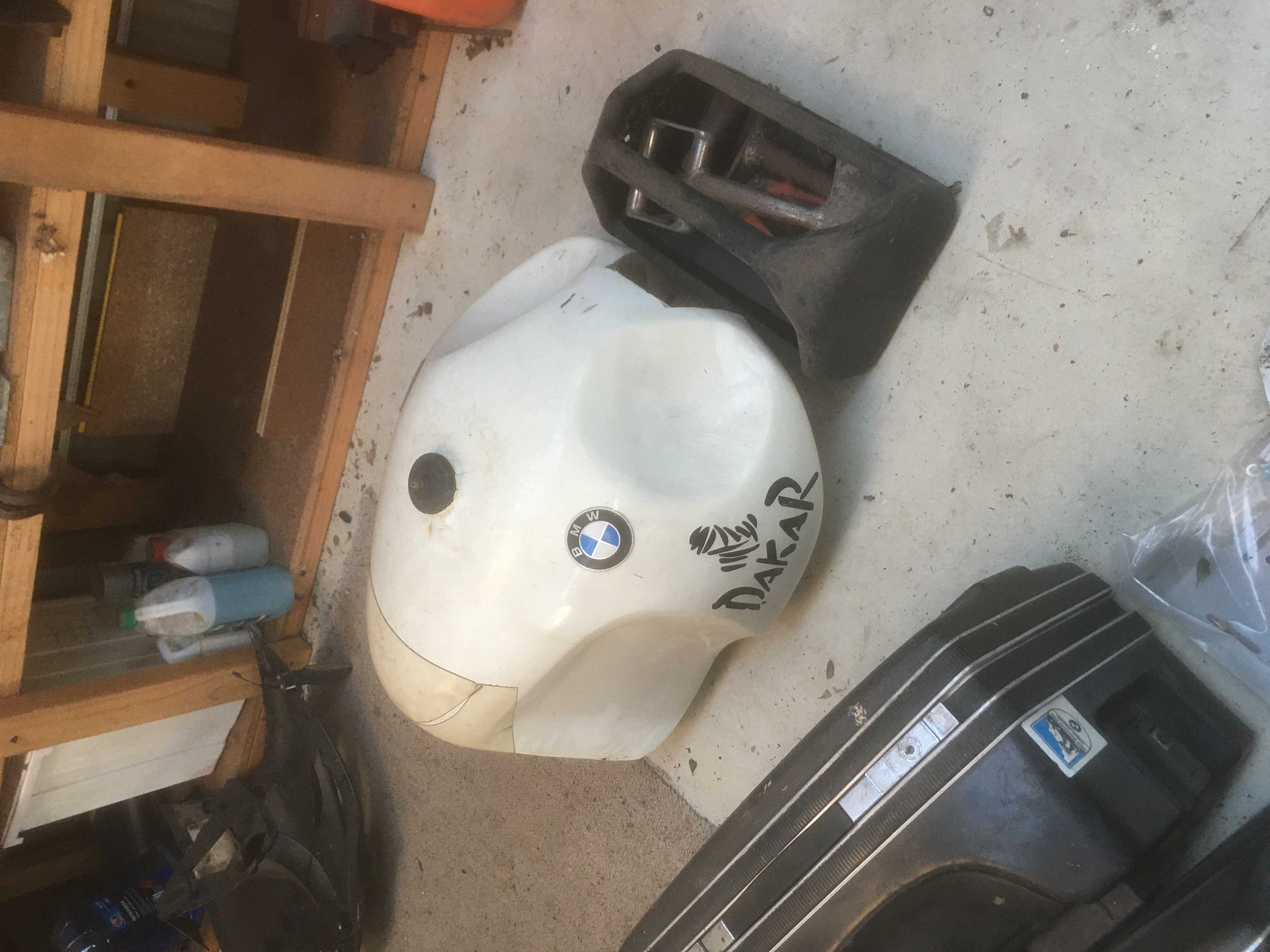

G’day all. I’ve just acquired a new tank for the mighty R80g/s. A rare 45 litre Heinrich (by Theofried Jekel) ….. massive, in great nick. Inside, the tank is unlined, not coated and by torchlight through the filler, has a very, very lite surface rust. After treating the rust I’d RedKote the inside before use. How would you go about rust treatment? Vinegar? Proprietary rust killer? What’s the current wisdom?
Thanks in advance. Hools
