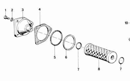

My worry here is that I had *literally* just done a filter change 10 minutes before taking this video. both rubber end-pieces of the previous filter separated from the filter and were semi-stuck to the end pieces (inside the chamber, and stuck to the cap). Not like, *melted* to them, but detached from the oil filter body, at least. It's entirely possible I didn't get the seal correct. But it was leaking similarly *before* this change, and only just noticed it after refilling it since this incident happened. I would be hard-pressed to say that I missed a leak of this severity over the last 800 miles. I just don't see that being the case. I can't completely rule it out, though.
Kind of what I had figured, and ultimately it came down to two choices: Castrol GTX Standard 20w-50 and the Valvoline VR1.
Noted. And thanks for the tips, as always. I'm *sincerely* hoping that this is nothing beyond "whoops" and I can get her back healthy again asap.
That danged $5000 O-ring
Positioning and condition of white O-ring #5 and metal washer #6 are CRITICAL.
# 4 gasket is not necessary (or even advised by me). The white O-ring renders the gasket redundant.
My bike hasn't used one since it's infancy.
I don't use it on customer bikes unless the customer insists on it after being informed.
There may or may not have been a service bulletin about this a hunnert years ago.
That white O-ring should NEVER EVER be re-used, but it's not included in the BMW filter kits.

Probably the best write-up I've seen on the $2,000 O-Ring:
http://largiader.com/tech/filters/canister.html
My 1978 /7 takes a shim and a gasket, as the canister is very shallow compared to the outer engine case.
The last filters I bought from Hansen's came with both a shim and an o-ring. They may have specified /7 or later when ordering the filters for stock, or it may be the way they're sending them now. I had previously bought shims and o-rings separately.
airhead vs. egghead?
This (and many other) insights on measuring canister depth, etc, are full of valid points to ponder but too time consuming and complicated for most airhead enthusiasts. Verrry long winded procedure and explanation for such a simple issue. I'm sure snobum's version is even longer.melville wrote: ↑Wed Jun 08, 2022 7:46 am Probably the best write-up I've seen on the $2,000 O-Ring:
The QUICK, EASY AND FAILPROOF way to 'measure' the gap is too put everything together and be sure that when you press the cover against the engine case that the white o-ring forces it to spring back out a bit. If the cover stays perfectly flush with the case when released, add another metal shim behind the white o-ring. For the record, I've personally NEVER had to add an extra shim, in literally thousands of filter changes.
Excerpt from your Largiader link: This is just an example, narrowly targeting a specific dimension! Do your own math to suit your own situation. In practice, the O-ring works in a fairly wide range of dimensions, so it's really unnecessary to apply this level of precision. You need to compress the O-ring, but it's not rocket science.
I recommend you don't use the gasket*, it can only cause problems. Deleting the gasket will just squash the white o-ring a bit more, which is a good thing.
*except on older flat cover pre white o-ring models where it is absolutely necessary.
If your filter has a center bolt holding it in, you need the gasket.
That's why I don't recommend using the gasket. That way, if the o-ring does fail, there will be an evident leak to the outside.Rob Frankham wrote: ↑Wed Jun 08, 2022 6:02 am Failure of the 'O' ring will usually lead to oil leaking from the filter housing back into the sump with little or no actual loss of oil to the outside
I remember discussing this issue in depth with different BMW factory service reps and technicians and at the time they were adamant that the way the infallible BMW engineers designed it in 'der fodderland' was the only correct way to do it. I proved them wrong, more than once over the years. Hence the moniker 'Mechaniker aus der Hölle' (Mechanic from Hell)
