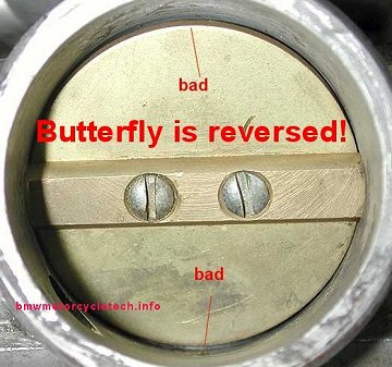

Butterfly on left card looks to be installed incorrectly. See how the previous mounting line on butterfly doesn't match the shaft.
Re: Brand new issue….won’t idle down?
Found it! Your throttle plate has slipped in the shaft. Loosen both screws and move it around until you can get it all the way shut. Then tighten both screws while holding it shut.
There's a shot the threads in the shaft are stripped. It can be repaired:
https://www.forum.boxerworks.com/viewto ... 76#p130076
The best way to do this is to fully back off the throttle screw and hold the arm closed while wiggling the plate around so it's centered in the bore.
Hold the carb up with a light behind it and center the plate so only a tiny crack of light is evenly showing when you look through it.
Maybe the plate was re-installed incorrectly at some point.
Be sure that the taper is facing the right way.
pics from snowbum below.
- download.jpg (10.29 KiB) Viewed 3020 times
- butterfly.jpg (37.91 KiB) Viewed 3021 times
