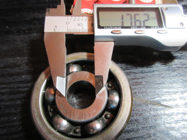

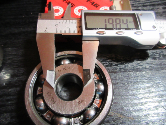

Turns out the large bearing (#23 12 1 338 795 for the the input end of the ouput shaft) they sent me is wrong.
The one they sent me has a taper on both sides. It should have a taper on one side of the inner race, and the other side should be flat. The flat side is so it butts up squarely on the circlip. I don't think this is common knowledge.

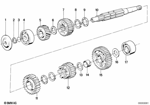

The older bearings supplied by BMW had the taper on both sides but this taper was filled with a small wire clip. (#3 in the Max fiche pic below) Now, the BMW supplied bearings all have a flat side and don't use that thin wire clip. That's why the thin wire clip is NLA; It's no longer necessary since they switched to a flat sided bearing.

6403? Is the shaft just 17mm where it runs through the bearing?
That's bicycle crank spindle size. That's an impressive piece of metal to take your abuse for 550K KMs.
Re: Jobber transmission bearing eff-up
The I.D of the bearing is 16.8xxx mm.

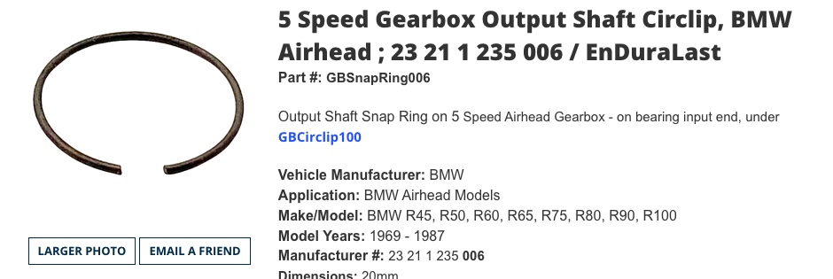

Update: EME does sell that NLA wire clip. https://www.euromotoelectrics.com/produ ... ing006.htm
but the correct way to do it is with the circlip up against the flat bearing and no wire clip.
BMW eliminated that wire clip and went to a flat bearing for a reason.
edit -
EME says it's for 1969 to 1987 model years
I guess the flat bearing started in 1988?
2nd edit -
I looked through the Max fiche and it looks that wire clip is NOT NLA.
It just wasn't used on later models.
It is listed for older models.
Maybe Rob F has a service bulletin about this or can figure out the exact date when it was changed.
Either way, the 23 12 1 338 795 replacement bearings from BMW all come with a flat side now (according to Ted Porter) so the wire clip is not used anymore if you buy OE BMW bearings and install them in any year bike.

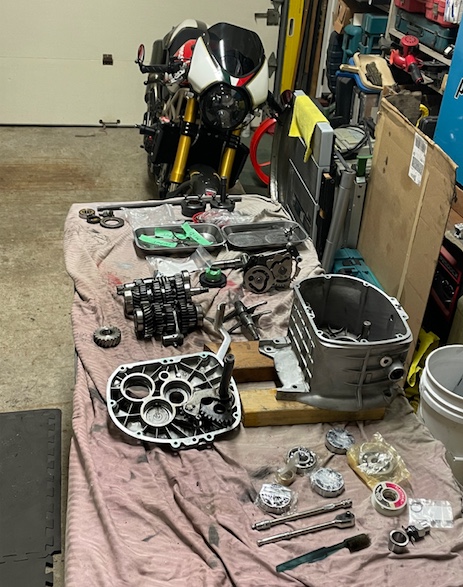

Rainy day Monday
The weather report, rain, rain, rain...
That motivated me.
That motivated me.

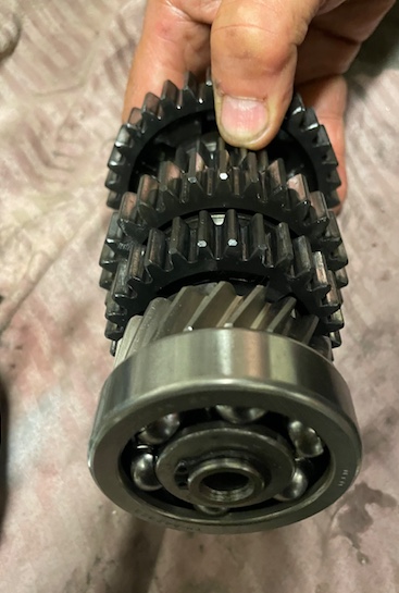

Safe at last
Finally have that infamous circlip!!! (and a higher 5th gear! and ALL new bearings)
I'm surprised after all the talk about that circlip that my tranny lasted 32 years and 560,000km without it.
In all fairness, I had replaced my front bearing on the output shaft twice during this time span. Never a failure, but twice when I opened the tranny for a routine (preventive maintenance) pawl spring replacement I noticed that that particular bearing was not spinning as smooth as new so I replaced it. Maybe now it will last as long as all the other bearings did.
I made mental notes of my speed vs. rpm in top gear at different speeds with the stock 5th gear, I'll report on my findings after a good ride. Hope it makes a noticeable difference.
