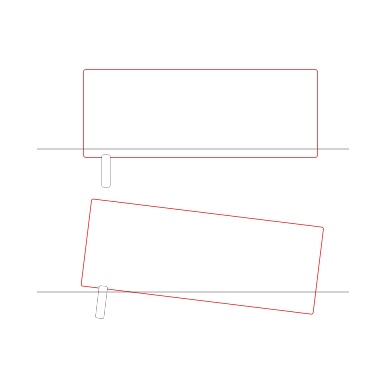

7 degrees of separation
In the top pic the gas level is over the pickup straw
In the lower pic I just rotated the tank 7 degrees forward.
The fuel level stays horizontal regardless of the tank angle.
Look where your .8 reserve supply ended up.
The solution: turn around and go back up the hill
I suppose if it was a life and death situation you could pull the front of the tank out of its support and prop it up with something like a piece of wood or a scrunched up T-shirt and continue downhill.

Re: 7 degrees of separation
Absolutely right. The only viable solution is to avoid running on reserve when there's any doubt about the nearest petrol station. When I lived in the South of England, where petrol stations are plentiful, I would happily run onto reserve in the sure knowledge that there was a fill up nearby. Moving to rural Scotland where fuel stations are few and far apart, I try not to run more than 150 miles (UK) before filling.gspd wrote: ↑Mon Oct 31, 2022 10:01 pm In the top pic the gas level is over the pickup straw
