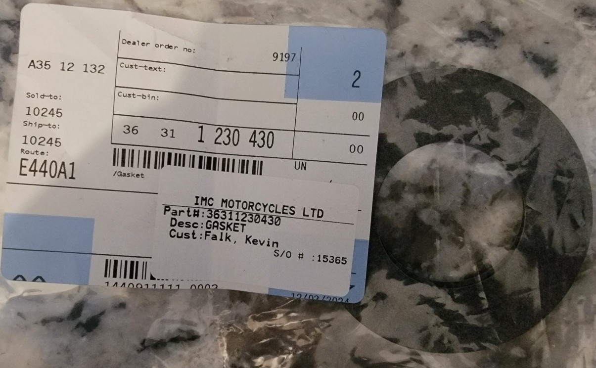

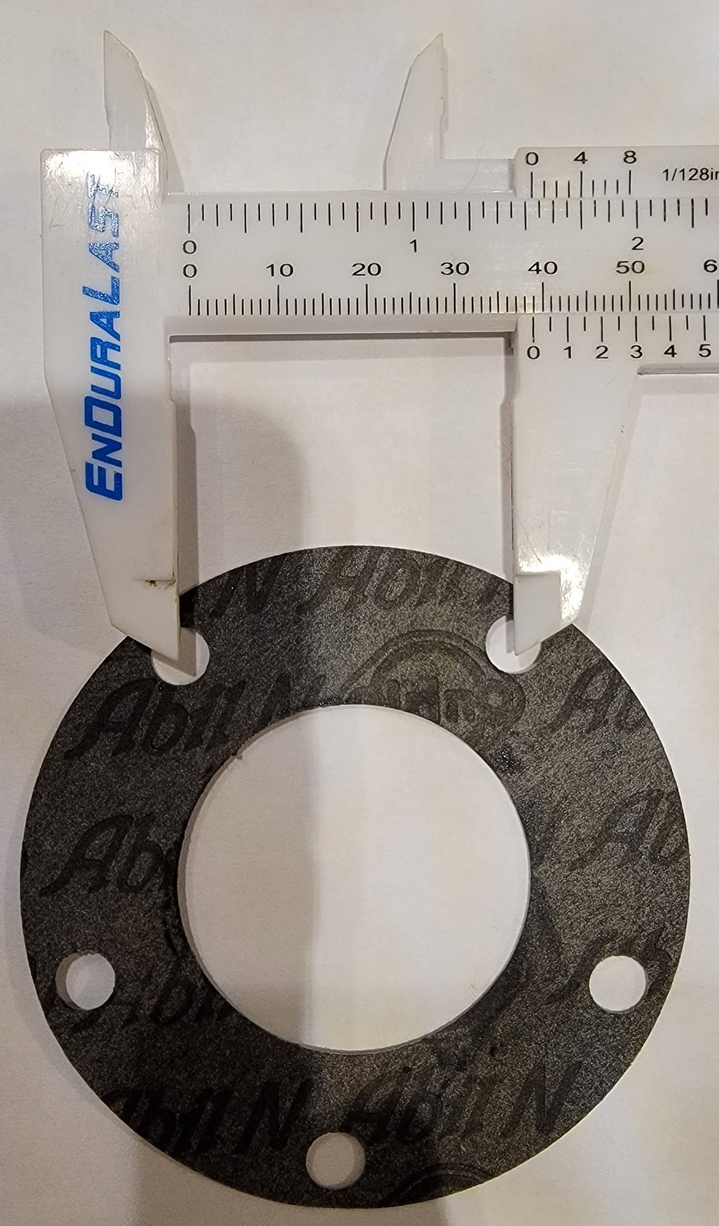

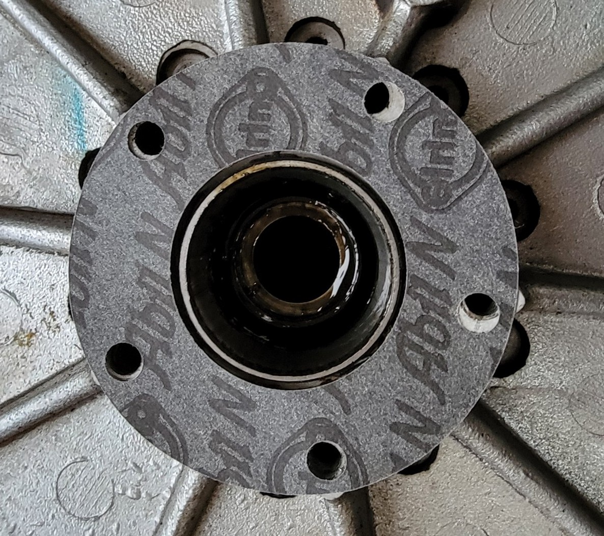

Hello all. I've run into a problem sourcing the front and rear wheel bearing cover gasket for a R50/5. I ordered two from a local BMW Motorrad dealer; see first image below. As you can see in the second image it doesn't fit. The third image shows the EnDuraLast version (which I have now ordered from EME in the US). The part numbers are the same. Has anyone else had this issue?

The problem is that the holes do not line up when I installed the round gasket (as you can see in the second image). This is what I received from a BMW dealer with the correct part number. I have now ordered from EME. The bike currently has the EME type gasket but they are not in good condition.

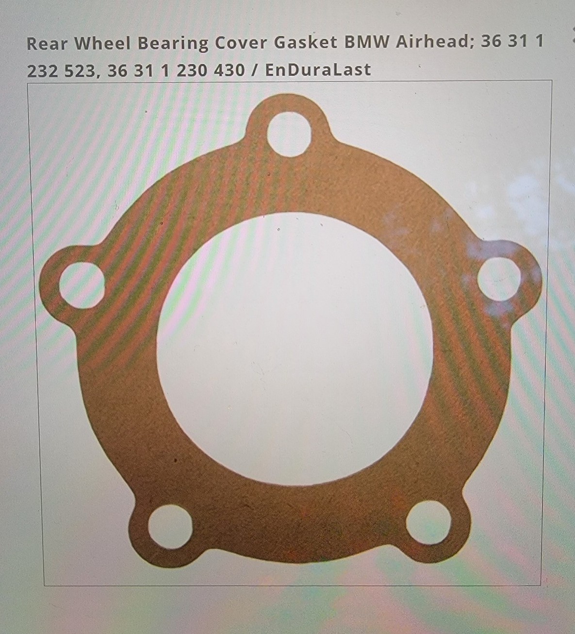

I used the image of the Enduralast part which is flat and used a bit of a drawing program to essentially show that all of those 5 holes are equidistant apart. I couldn't do that on other things because they were not straight-on shots. But I'll be curious to see how the holes come out on the actual wheel.

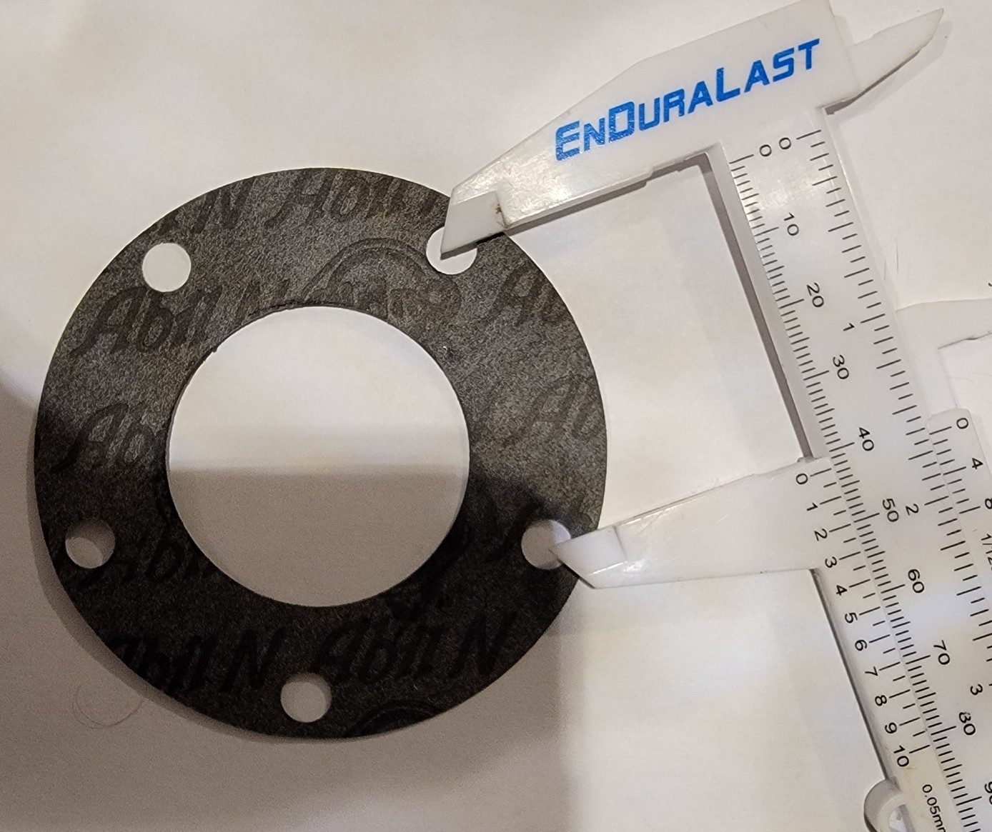

I couldn't find a protractor so I measured distance b/w the holes. The round gasket holes were either 39mm apart or 42mm while the actual bearing cover was 41mm b/w all holes.
