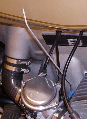

I spent a little time just feeling the tension on the throttle cables and adjusting them to something that felt equal enough with a visually equal lift time. Once running it seemed the cable adjusters were very close but still took a little bit of back and forth between sides.
I use the knitting needle method for a basic mechanical balance. Take two slim and very lightweight knitting needles and pierce a short length of rubber tube that pushes onto the inside of the butterfly spindle. Then sit astride the bike and gently open the throttle while watching both needles to see which twitches first. Amplifying the movement of the spindle by that long length makes It very sensitive.

barryh wrote: Fri Jan 31, 2025 4:17 amI use the knitting needle method for a basic mechanical balance.
Very cool!
Re: Tuning.
That's clever :!:
