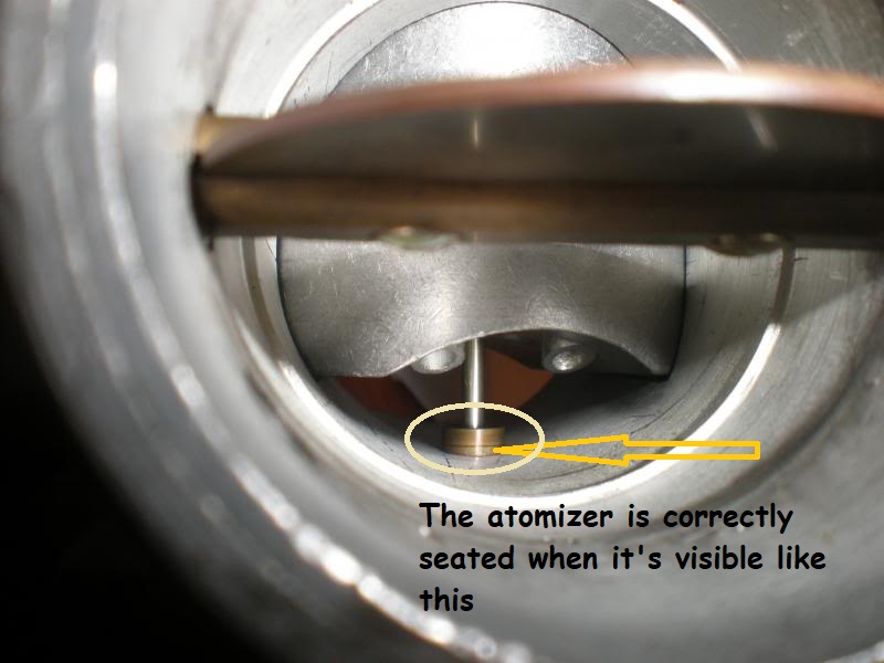

sap06003 wrote: Mon Jun 30, 2025 11:27 am ... Next i cleaned the carbs, which were brand new when installed, i found a small piece of metal sitting on top of one of the main jets! Fired right up and ran pretty well after that.
I'm wondering where that piece of metal has come from? Reinstalling the atomiser needs to be done to avoid cracking the intake bore. It might be worth taking a look there. Though, I can't see how a small metal part from there would relocate itself to above the MJ?
2. bing throat.jpg (83.37 KiB) Viewed 13626 times
