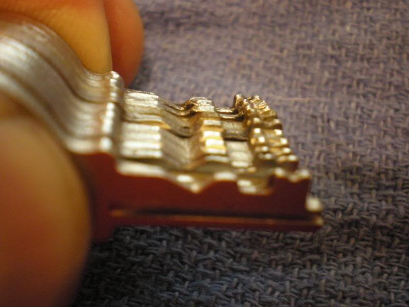

The cut profile for the keys for the BMW motorcycle panniers from the 1980's is identical across all numbers (I believe, as per the picture above). The difference is in the keyway/longitudinal profile of the key shaft.

Unfortunately, most locksmiths won't touch this sort of key... their cutting machines don't work in this way so it's all hand cutting... those that will are likely to ask silly money.
As I've said, if you are fairly handy with a dremel and jewellers files, it's quite possible to make them yourself given that all the information you need can be obtained from any key in the range and the part of the lock that accepts the shaft of the key. I've done it a couple of times and the results, while not pretty, work perfectly. Put simply, if you have a key with the right profile that will fit into the lock, it will open it. These locks aren't really secure... they are more about keeping the locks shut as you drive than preventing theft... and the tolerances are high.
