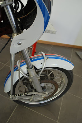

floating brake anti dive
Period correct !
Floating brake anti dive is '70s tech.
