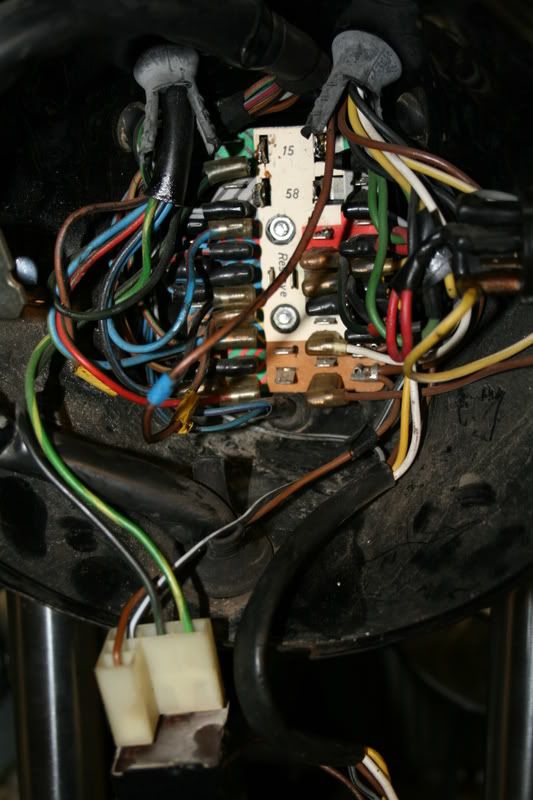

Hi to all, trying to find out the part number for the O.E hella blinker relay" wiring loom ", has the "L" plug that clips onto the base of the relay looks like it's wired into the fuse board itself

!, model is a 4/1975 R90S. Thanks for the link also. I can indentify the part that im looking for on google images but not on the parts fiche. If i could i'd load a picture of the part im looking for would be a lot easier for all to see/help if possible

Here are the pictures. Gary is after the white plug that connects to the flasher relay...Is it oem or not, that is the question?.

That connector block isn't really necessary. All those wires going into it have female connectors, just connect them in their respective positions.
Re: I.D part number
But if he really wants originality, the block is available. It looks like # 15, to me.
http://www.realoem.com/bmw/showparts.do ... g=61&fg=13

Part 61131351283 (Plug housing) was found on the following vehicles:
2474: Details on 2474
2474 R 100 /7T N/A
2474 R 100 /T N/A
2474 R 100 CS N/A
2474 R 100 RS N/A
2474 R 100 RT N/A
2474 R 100 S N/A
2476: Details on 2476
2476 R60/6 N/A
2476 R75/6 N/A
2476 R90/6 N/A
2476 R90S N/A
2477: Details on 2477
2477 R 60 /7 N/A
2477 R 75 /7 N/A
2477 R 80 RT N/A
2477 R 80, R 80 /7 N/A
2478: Details on 2478
2478 R 100 RS N/A
2478 R 100 RT N/A

Thanks Rob and Steve excellent work , its the part that im looking for and via Steves listing Info as N/A . Looks like i'll be looking for a second hand part. Have time to do these small jobs on the bike that i always wanted to do after the bike was rebuilt , so the hunt begins. Any forum member have one for sale ?
