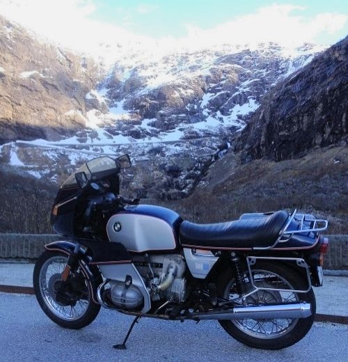

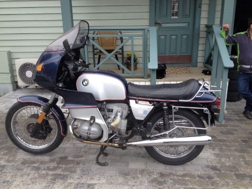

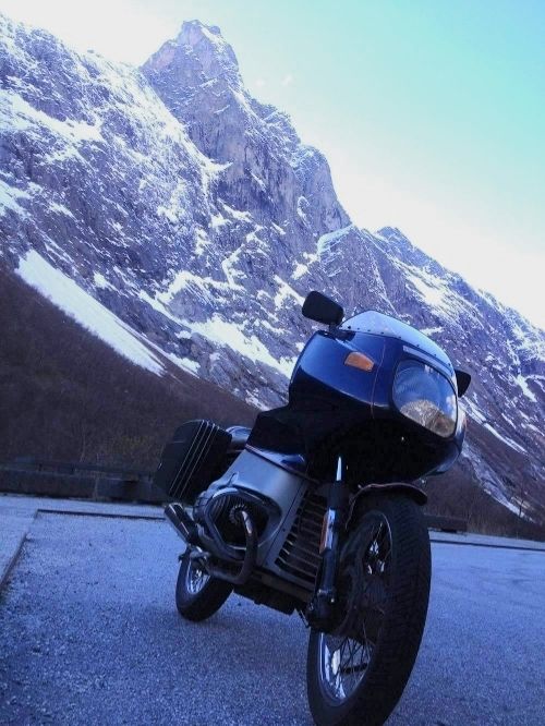

Here are some pics of the bike, i changed to the lower fairing screen. Sorry a couple are a bit dark, i can take some more in better light.

Re: New bought 77r100rs
That is a sweet looking bike. You are a lucky man and the envy of many beemerphiles.
If you haven't done so already you might look around for pics of a '77 R100RS. Here's a link. The silver blue ones I believe were the only color offered in the US market. Somebody here will know for sure.
