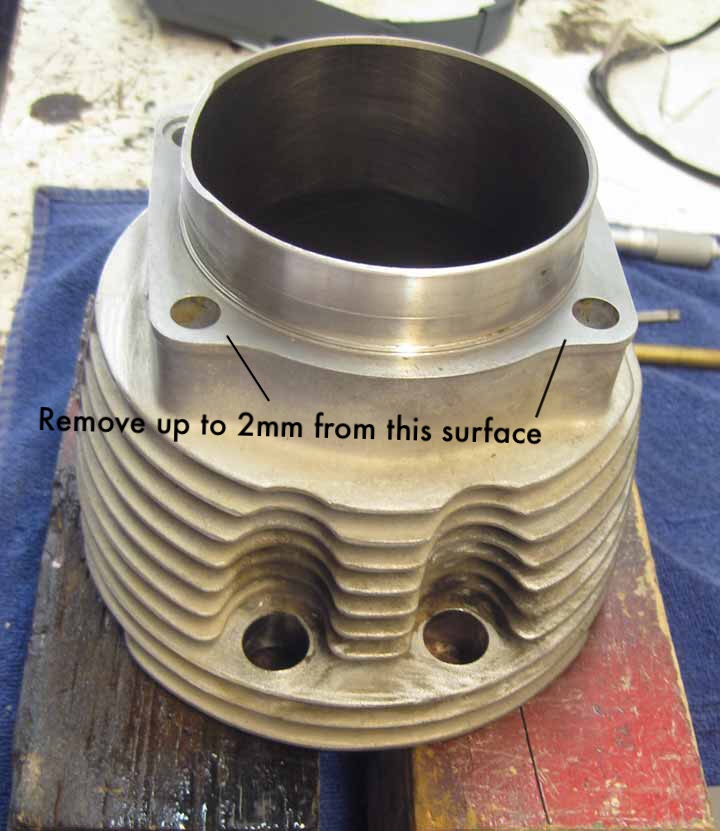

I'm looking for a machine shop that has experience turning material off the base of airhead barrels.
Preferably close to Western Washington. Looking to do a comp increase without modifying the heads.

I'm thinking that any competent machine shop could do it. I gather that we are talking about reducing the diameter of the barrel spigot that goes into the block. I suspect that the hardest part of the job would be getting the barrel truly square and centered on the lathe chuck, presumably using a 4 jaw chuck. The top of the cylinder, which presumably would bear against the chuck, would need to be square to the cylinder bore. Since the lower flange on the barrel was (presumably) square when the cylinder was first machined and (again presumably) the top of the cylinder was square with the lower flange I would not expect the job to be as demanding as if shimming and such were needed to square the cylinder to the chuck.

No Ken, reducing the length of the barrel (so to speak) to increase compression.Ken in Oklahoma wrote: I gather that we are talking about reducing the diameter of the barrel spigot that goes into the block.
Ken
Re: Turning off material on airhead barrels. Who does it?

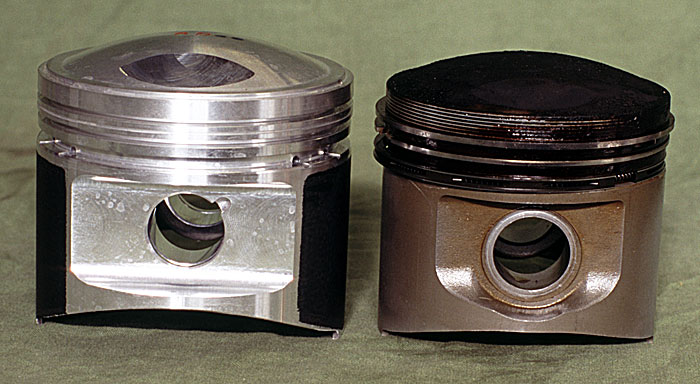

Exactly. I want to increase compression without messing with the heads. I have R90 heads and stepped 1000cc Siebenrock pistons. This is the prescribed method in the famous german 336 bulletin. I can't find a link to it anymore, it used to be here http://moragafalconers.org/BMW_336_Cam/ ... 0Draft.pdfME 109 wrote:No Ken, reducing the length of the barrel (so to speak) to increase compression.Ken in Oklahoma wrote: I gather that we are talking about reducing the diameter of the barrel spigot that goes into the block.
Ken
If I milled the heads The stepped area outside the R90 squish band would remain at 2mm while the inner portion of the piston band would get tighter. This would force some of the charge the wrong way. Machining the base of the cylinder makes everything come together evenly.
It may change the PR tube alignment very slightly, but I think there is quite a bit of wiggle room there.
I wnat to bring the compression ratio up to a little over 10:1 from the current 9.5:1. According to the bulletin, removing just .5mm should do this, but I also want to be able to use the R90 base shims with my small spigot Siebenrock barrels.
