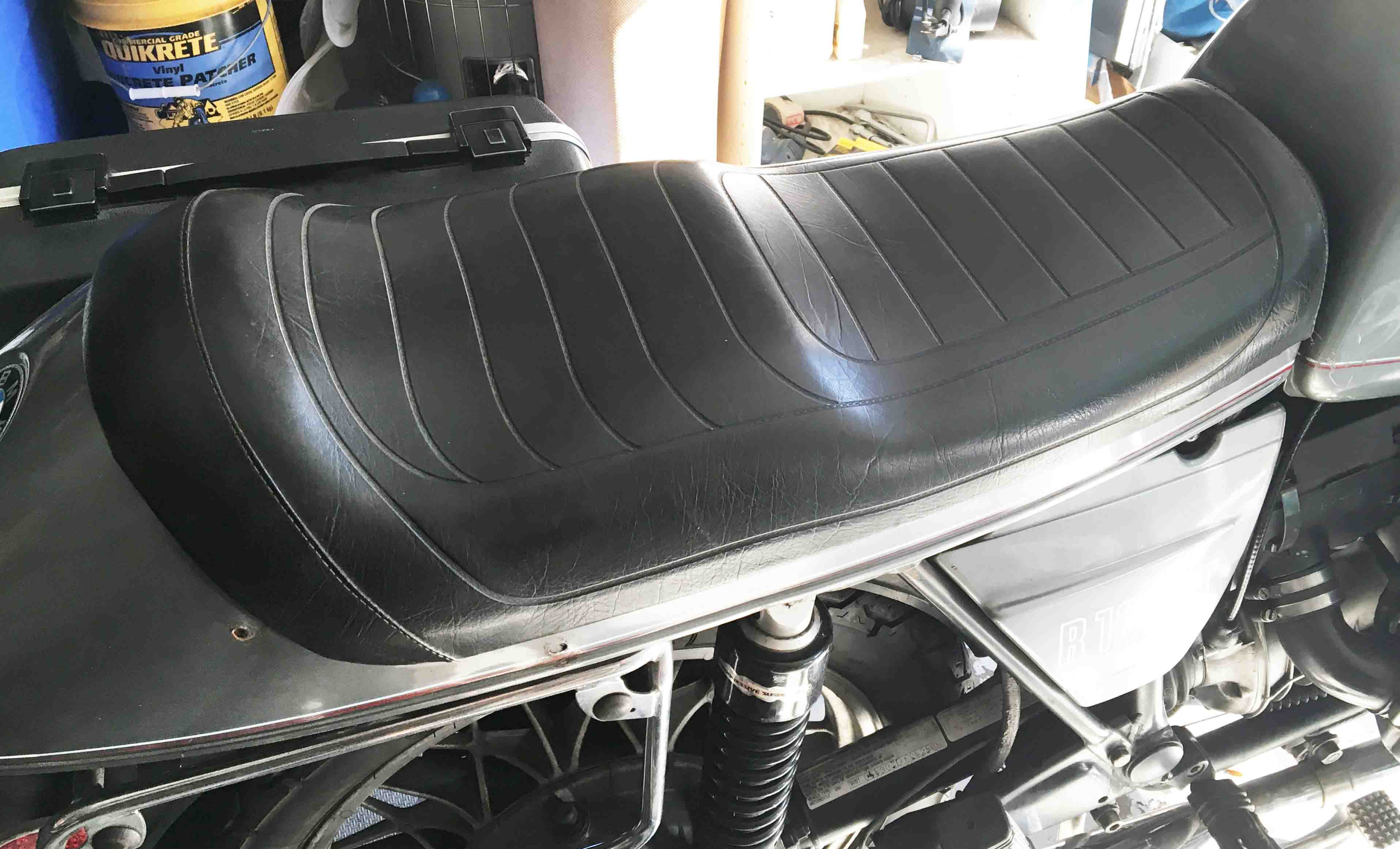

One of the most important changes I wanted to make on my new to me 83 R100RT was to remove the Corbin aftermarket seat and replace it with an OEM seat I found on Ebay - The seat I purchased on Ebay is a nice original seat with the hinges, rubber grommets and "pin" piece that snaps into the lock all present from factory.
I unscrewed the Corbin from the R100RT seat frame and attached my OEM replacement.
When I got the assembly back on the bike, after struggling to get the hinges over the frame rail and in position, i got it in a good position and it will now close properly/level but the pin (that snaps into the lock mechanism) WILL NOT ENGAGE and lock - It seems the pin needs to be a bit longer - I noticed the pin on the Corbin seat that I removed has a washer/shim to make it a bit longer to engage lock.
Does the original pin have any adjustment?? Can it be turned to lengthened??

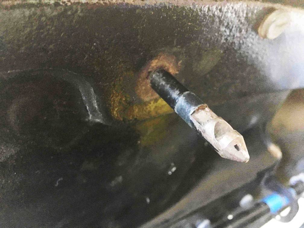

Pull that tapered rubber thing off of the spike and take a look. Probably a jam nut you can loosen and extend the spike some. Make sure the notchis pointing in the correct direction after turning the spike .

Pull the conical rubber of the latch post, as George said and see if it closes.
Careful trying to turn the latch post, it will most likely be rusted to the nut (under the seat foam) and could break away from the seat pan.
The latch itself may also be worn, preventing engagement of the latch post.

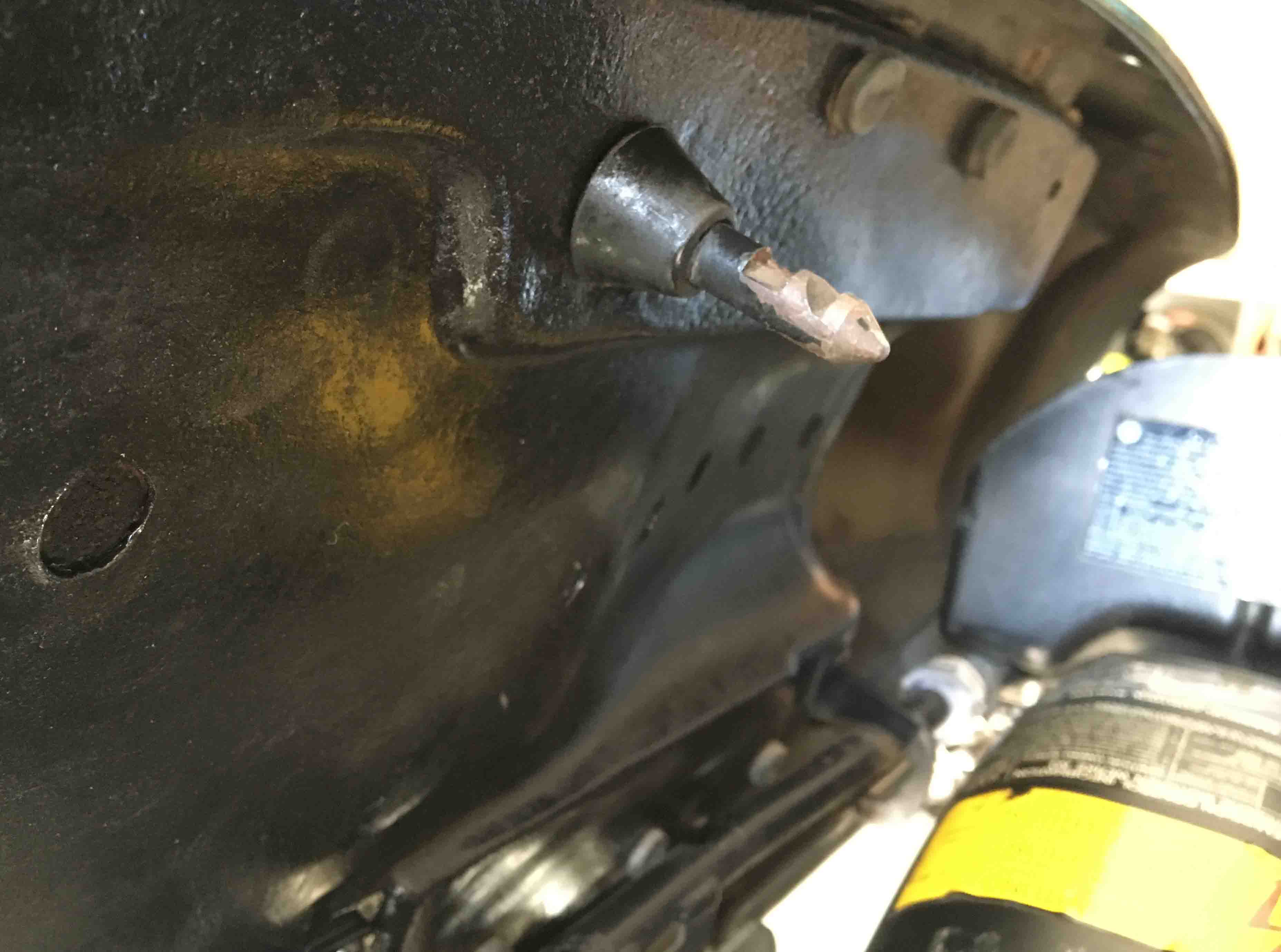

Re: '83 R100RT Seat Swap - Bummed my seat won't fit properly
the receiver latch is in good working order and worked fine with previous seat i removed. i removed the rubber washer off the pin and there is no adjusting nut and looks as if there is no way to adjust the pin - pin looks welded to the seat bottom - photo attached

That seat looks like it's been cleaned up and painted at some stage. The paint is usually a flat to satin black that flakes off and shows light surface rust underneath. It's commonly seen. The bolt is attached on the other side of the base by a weld, so no adjustment. Sometimes that bolt can lose its alignment just a bit.

SteveD wrote: The bolt is attached on the other side of the base by a weld, so no adjustment.
I must be nuts saying the latchpost was held by a nut. What nut?! It's the same stupid idea as the hinge mounts.
