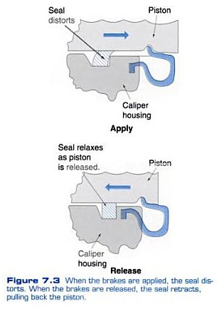

I used to have that problem until I learnt to lubricate the caliper pistons with red rubber grease, Deformation of the seal is designed to withdraw the piston when the brakes are released but it can't do that unless the piston is free to move. I've just been out to the garage and given the font wheel a spin by hand. It took 25 secs to come to a stop. That's what you are aiming for and it is achievable with clean lubricated pistons.
- Brake Seal.jpg (33.42 KiB) Viewed 3965 times
Re: Sticking Brakes
Barry, thanks for the excellent pictorial.
