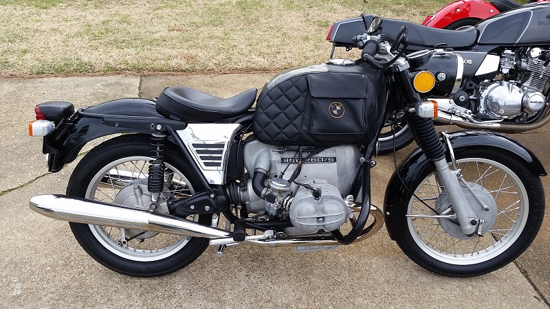

I came across a deal that I could not pass up a couple of weeks ago, the bike was just too clean! Even though I didn't need another bike, I bought my first Airhead, this little bike is awesome! I'm going to make some modifications to the bike, but nothing to the point where it can't be returned to 100% stock. I will be replacing the large stock mufflers with some shorter, more free flowing ones soon. What jetting adjustments do you recommend for making this change. (PS. I will not be changing the stock intake)
And also, the previous owner added a large capacity oil pan to the bike. What oil is recommended, and how much?

Those are not the stock carbs that the 60/5 came with so specific advice on jetting isn't going to be realistic. Probably won't need changing anyway but that may depend how well those carbs were set up. They are known as flat top Bings and were only fitted to some later models in 78-80. The original carbs would have been slide type Bings rather than CV's
Use a good quality 20W50. Again oil quantity for a non stock pan is uncertain. Start by assuming min of 2.5 litres. Take a look here for info on pans and dipsticks http://www.largiader.com/tech/oilpan/

barryh wrote:Those are not the stock carbs that the 60/5 came with so specific advice on jetting isn't going to be realistic. Probably won't need changing anyway but that may depend how well those carbs were set up. They are known as flat top Bings and were only fitted to some later models in 78-80. The original carbs would have been slide type Bings rather than CV's

I have been looking at pictures of R60'5's, and I thought my carbs might not be the ones that the bike came with? Thanks for confirming it for me!
As far as the oil, is synthetic ok? I use only Mobil 1/Amsoil in my cars, but I know some of the older engines don't like synthetics.
Thanks again ...
