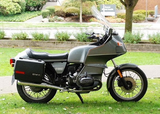

Heres a photo of the OEM seat installed - I purchased the smaller seat rail and awaiting it's arrival. The old rail had the passenger seatback and I'm not crazy about that look nor do I take passengers.

Bewdiful bike. Define "muscling". What did you do?
