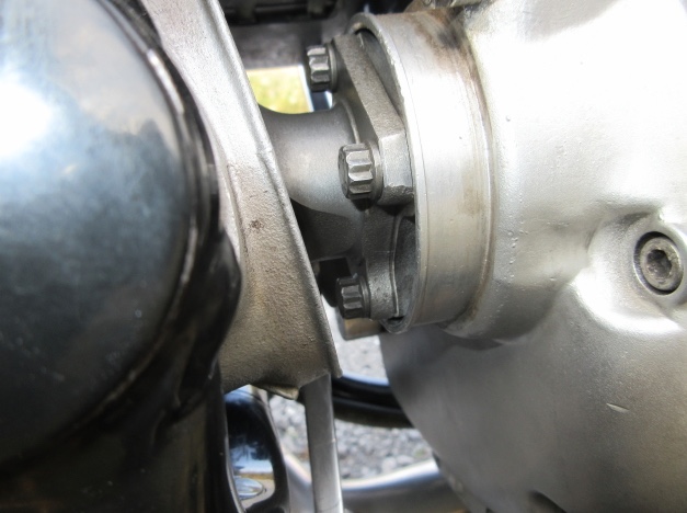

Just got back from a 350 km beat test test ride.
Not a hint of a leak, not even a minor sweat!!!
I left the front boot off so I wouldn't have to remove the clamp and stick my finger in the boot to check for leaks.
It felt almost preverted to ride around with my shaft exposed.
A few blips up to 100mph, but mostly not too much over-speeding because it's the start of the Canadian Thanksgiving weekend and the blue meanies are out radaring in full force toprevent road carnage fill their coffers.

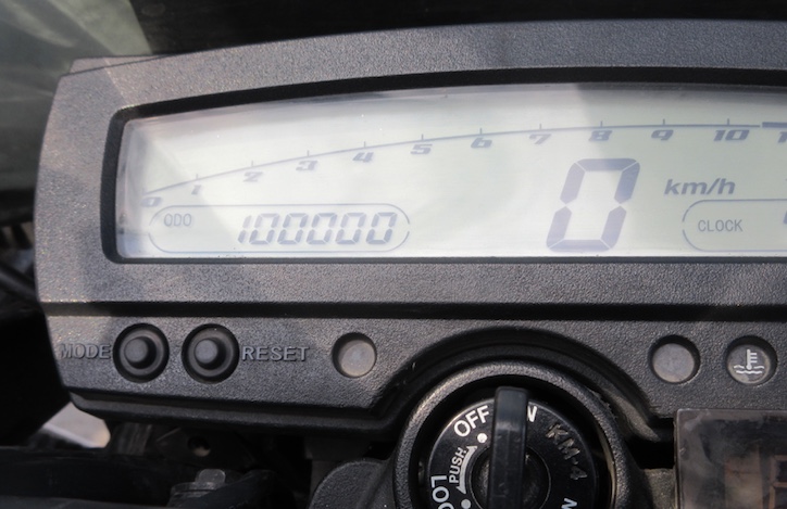

Another surprisingly pleasant but unrelated note, my wife's klx250 300 just turned 100,000km.
Never thought those little bikes were so tough.

What is correct for a R80 or and R100 (Monolever) isn't necessarily correct for a R100GS or a Mystic/R (Paralever). The same seal is used for both, just the other way round. The change in seal was a general change of seal type applicable to all 5 speed gearboxes not a change that co incided with the change from Mono to Para. Just saying... if it seals (and stays sealed) well and good...
