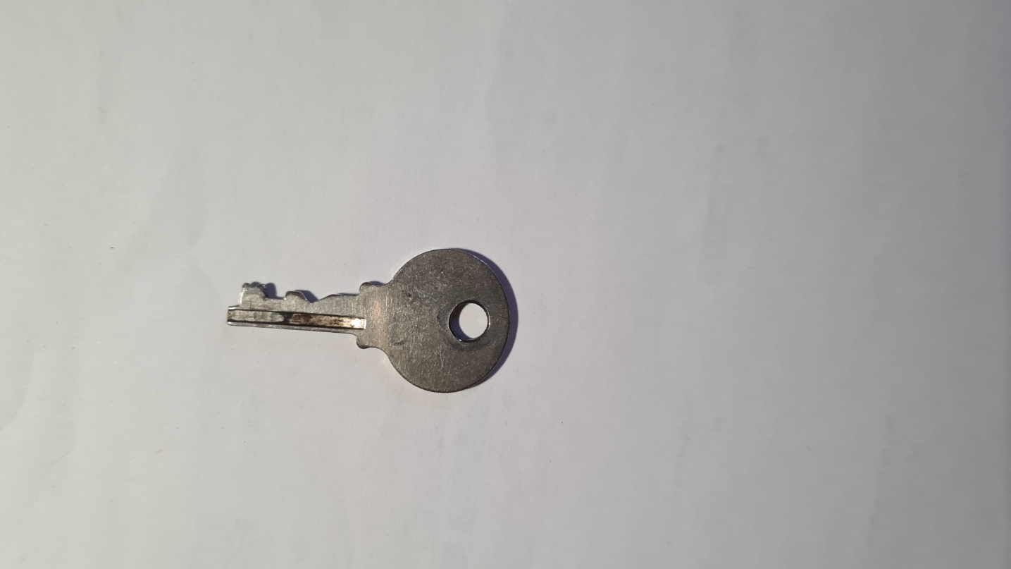

Can you send me a photo of your 057 key beside a ruler for dimensions as per your post below. I will try and fashion one myself.
Thanks
Mike
"As it happens, one of my sets uses 057 keys but I only have one so I'm not able to supply it. If I can help with pictures or measurements, let me know..."

Apologies, taken me a couple of days to pick this up... I will try to get some reasonable images, bear with me...
Re: Krauser panniers 1991
No 057 Key
Duplicating these images here for convenience...
Key 057 Profile (photo).jpg (187.64 KiB) Viewed 2940 times

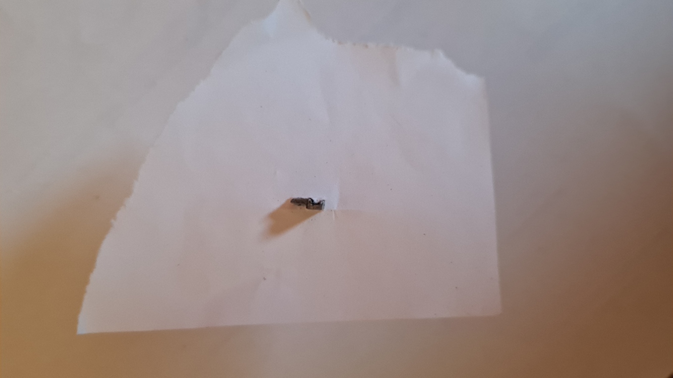

Key 057 Bottom.jpg (161.04 KiB) Viewed 2940 times

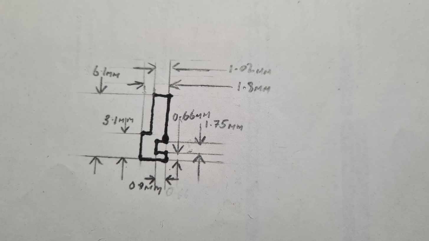

More 057 Key
Key 057 Top.jpg (201.47 KiB) Viewed 2940 times
Key 057 Profile.jpg (246.81 KiB) Viewed 2940 times
